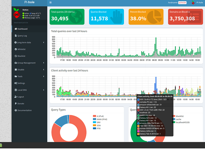

My pihole on my raspberry is also the dhcp server. Is it possible to see the ipv6 as it can be seen with the ipv4 addreses from the devices.

I may not understand your question. Your screen capture of the dashboard shows that some clients are being reported by IPv6 address.
