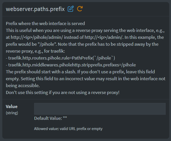

Did you also need to configure the webserver.paths.prefix setting?
No, I haven't had to touch webserver.paths.prefix yet. Although I only have 1 server with pihole upgraded to V6 so far. My second server with pihole is still v5. That's on 192.168.1.4. Will need some time spare to work through whether this current proxy config will be sufficient to manage both servers.
It's that option in the webui? Or just in the pihole toml file?
It is a bit hidden in the WebUI.
You find it by
  1. Go to a settings page site and toggle the switch on the top right from Basic to Expert.
  2. You'll now find All settings in the left menu pane.
  3. On the All settings page, switch over to the Webserver and API tab to find the webserver.paths.prefix option.
But you can also change this setting from the CLI with
sudo pihole-FTL --config webserver.paths.prefix "<value>"
