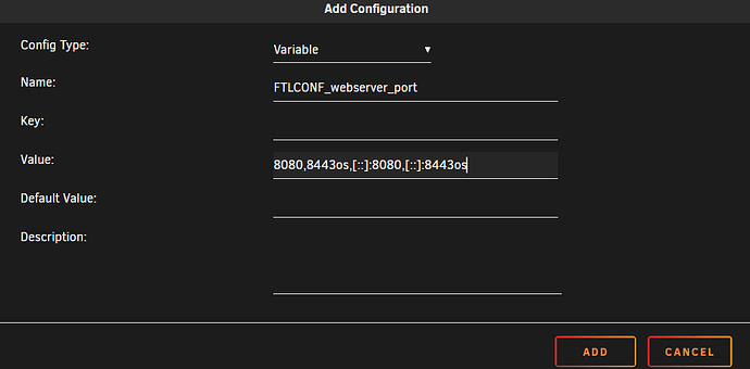

I can't access the /admin page to make any changes to this settings - is there a way to add it as a variable to the docker image manually?
Sure, as mentioned:

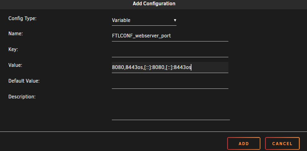

Sorry, i'm still fairly new when it comes to manually amending Docker images, i see this but have no idea what each bit is supposed to contain to get Docker to apply this change:
Your screenshot shows neither a docker compose nor a docker run script, but some third-party administrative UI for Docker.
You'd have to consult that tool's documentation and figure how to create an environment variable for your Pi-hole container (the equivalent of using -e FTLCONF_webserver_port: '8080,8443os,[::]:8080,[::]:8443os' with docker run).
If that's what the screenshot is about, it may be correct, though I'd guess that you'd also need to populate Key: the same as Name:.

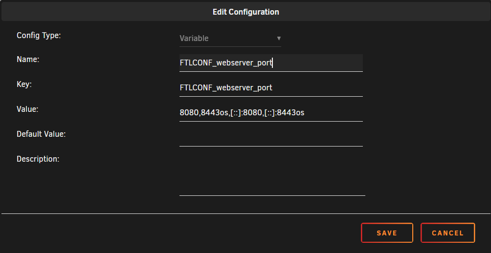

I never used Unraid, so this is just a guess, but I think the Name: field is just a description of the variable (a comment).
I think you need to use the pair Key: and Value: to actually set the variable.
Also, try with ('8080,8443os,[::]:8080,[::]:8443os') and without (8080,8443os,[::]:8080,[::]:8443os) quotes around the value.
Whoa!
Ok so this got me to the Webui for anyone else who stumbles upon this post:
I'll try playing with Pi-Hole properly now and hoepfully get it working on my network, exciting ad-free times :smiley:
Thank you all for your help!!
