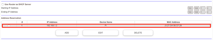

@Mcat12 thanks for your reply. My understanding is I need one DHCP reservation on the router for the Pi (192.168.1.2) to prevent this IP from changing.
What I've ended up doing here (based on this comment) is keeping the router's DHCP server enabled, but to a range of just one address 192.168.1.2. This same address is set up in the router as an address reservation.
The router's DNS server is also set to 192.168.1.2:
As for Pi-hole, I've set the available address range outside of this to prevent any clashing:
All other static IP address reservations I've set up within Pi-hole:
Does this sound like an appropriate setup to you?
You do not need to run DHCP on the router if you are running it on Pi-hole.
@Mcat12 but don't I need a fixed IP for the Pi itself that's running Pi-hole?
Are you suggesting I set this up as a DHCP lease within Pi-hole? Disabling the router's DHCP server (which is only using one address like I say) makes my devices unavailable on the network.
You do not need a DHCP lease, as Pi-hole is already set up with a static address. A static address is different than a static lease.
I see, thank you @Mcat12. I have now disabled DHCP on the router.
Just as a final clarification (sorry!) although DHCP is disabled, the address reservation on the router setting the IP for the Pi as 192.196.1.2 should remain?
As DHCP is disabled, the address reservation is also disabled.
Fair enough, but then how do I set the IP address of the Pi to 192.168.1.2? This is outside the range in the Pi-hole settings, so it can't be set there?
