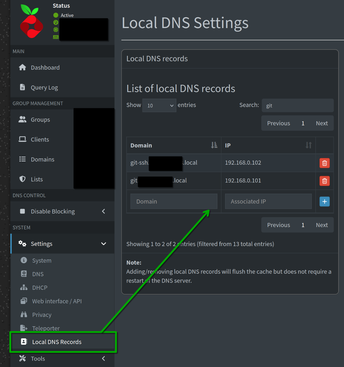

Then I finally setup Pi-hole's local DNS records with the above URL and corresponding IP address:
For Forgejo specifically, I also chose to expose the Forgejo container's IP Address (192.168.0.102 ), and update Forgejo's config file, app.ini to use that URL as the SSH Git Clone URL. This would let me clone Forgejo repos via SSH. Cloning from HTTPS didn't work, but then again, that was expected given Caddy doesn't generate a Let's Encrypt signed certificate if the URL ends with *.local (or is localhost). In the near-future, I'll probably look up how to setup an internal ACME server, and setup the Caddyfile to consult that instead to verify the certificate, but that's a question for another forum, and I'm getting off-topic.
