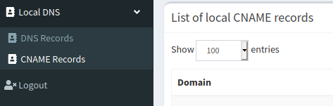

Setting to set higher entrys in DNS pulldown-menu
I am annoyed by 10 entrys of DNS / CNAME list...
How set this fix up to 100?
Is it possible to create a entry in pihole settings to set it higher, for the next time?

...well, my list is long... my cname list... and i have 22 clients... so...
i wish, i can make me an overview by first view... and not using the pull-down-menu first and switch on to 100 list entry... but this is temporary until next logon...
at standard, it could be set to 10 entrys... but my net is bigger... :wink:
Pull down menu? What is the exact page you are talking about please.
...more than words...
...i wish to set "show 100 entrys" fix...

Actually the setting for both, the Local DNS Record as well as the CNAME table, is stored already in the browser's local storage. You need to find your browser's setting for clearing the storage on exit and make an exception for pi.hole
https://github.com/pi-hole/AdminLTE/pull/1563
