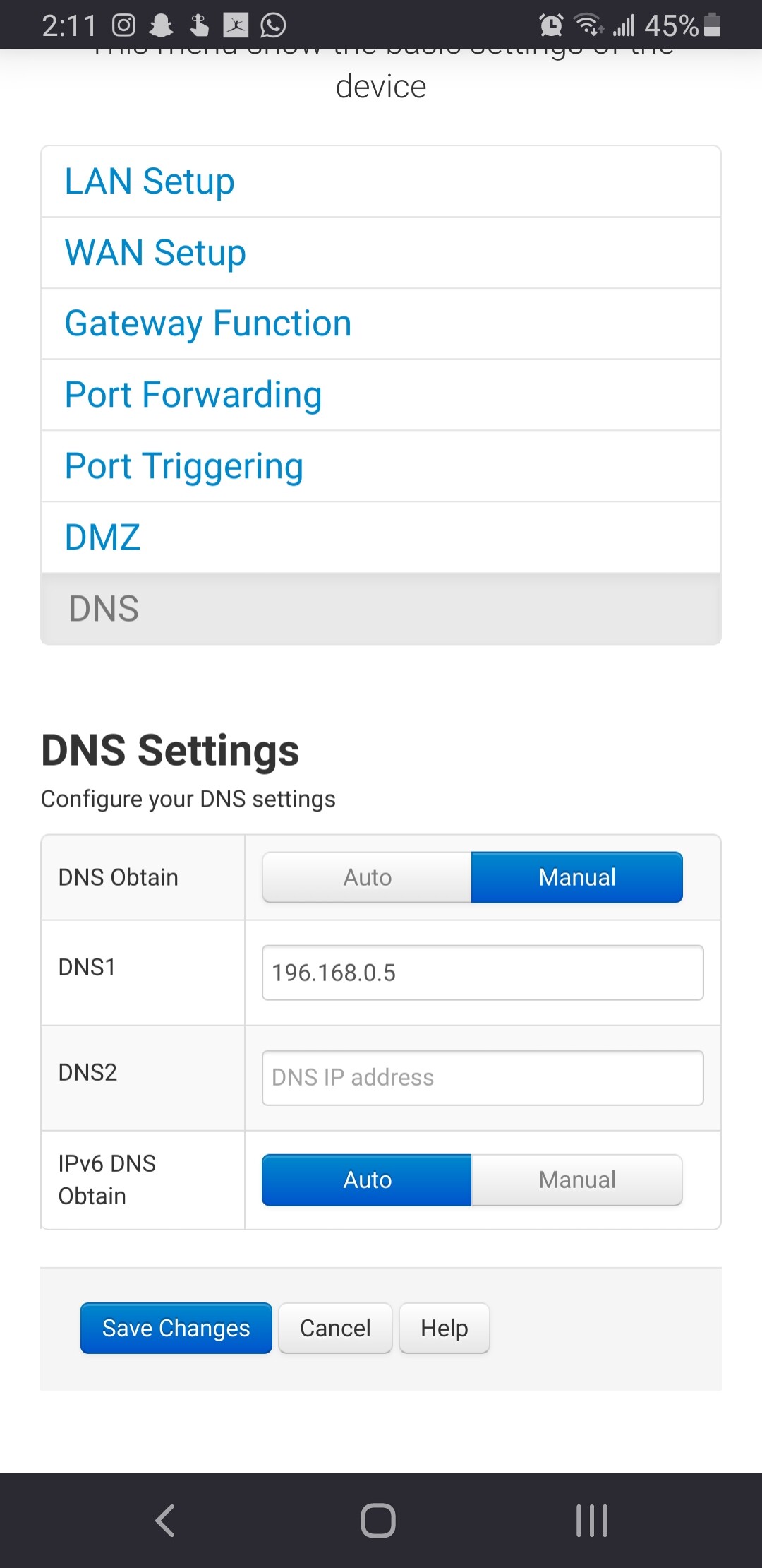

Setting Pi-Hole within the Hitron DNS -> Manual -> IP Settings should allow my machines to use the DNS Server

I'm thinking this is more my routers fault too. There's only one spot in the basic Hitron router offered by my ISP (Shaw) to set DNS, and when putting it like this, the server does get set on devices on DHCP but no internet connections can be made.
I set PiHole as my DHCP server and everything seems to be working OK, but I'm a bit concerned about having the pihole go down and suddenly I don't have a DHCP server. Is it possible there's multiple spaces to configure DNS? I didn't modify the WAN one at all.
I do not know your router at all, so it would be hazardous guessing to judge what your router does by just a screenshot.
You really should consult your router's documentation and support for details.
It looks like that screenshot was taken on a smartphone.
If that is indeed an app, it may be worth checking whether your router would offer a web interface as well. It wouldn't be uncommon that the web UI may offers more detailed configuration options and/or more detailed help than the app.
Purely based on the button labeled Obtain in those DNS settings, I would consider it more likely that those settings would refer to your router's upstream DNS server rather than the local one distributed by DHCP - the latter one would commonly default to the router's own IP in lieu of manual configuration, so wouldn't be obtained, while in case of the former, your ISP would tell your router which upstream DNS servers to use.
