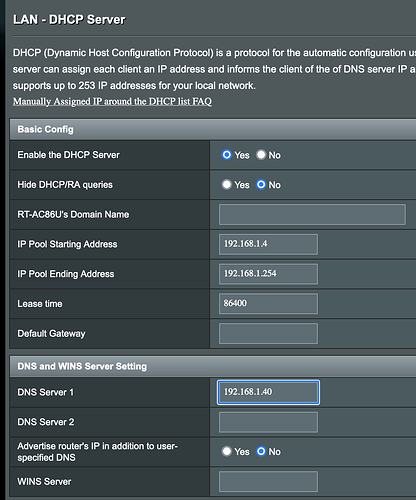

  • In LAN settings, I have set up my router as DHCP server, and the the pi as the DNS
  • When I do this, traffic seems to be routed correctly through the Pi. I can see the queues up up on the web interfact. However, I cannot access any outside URL.

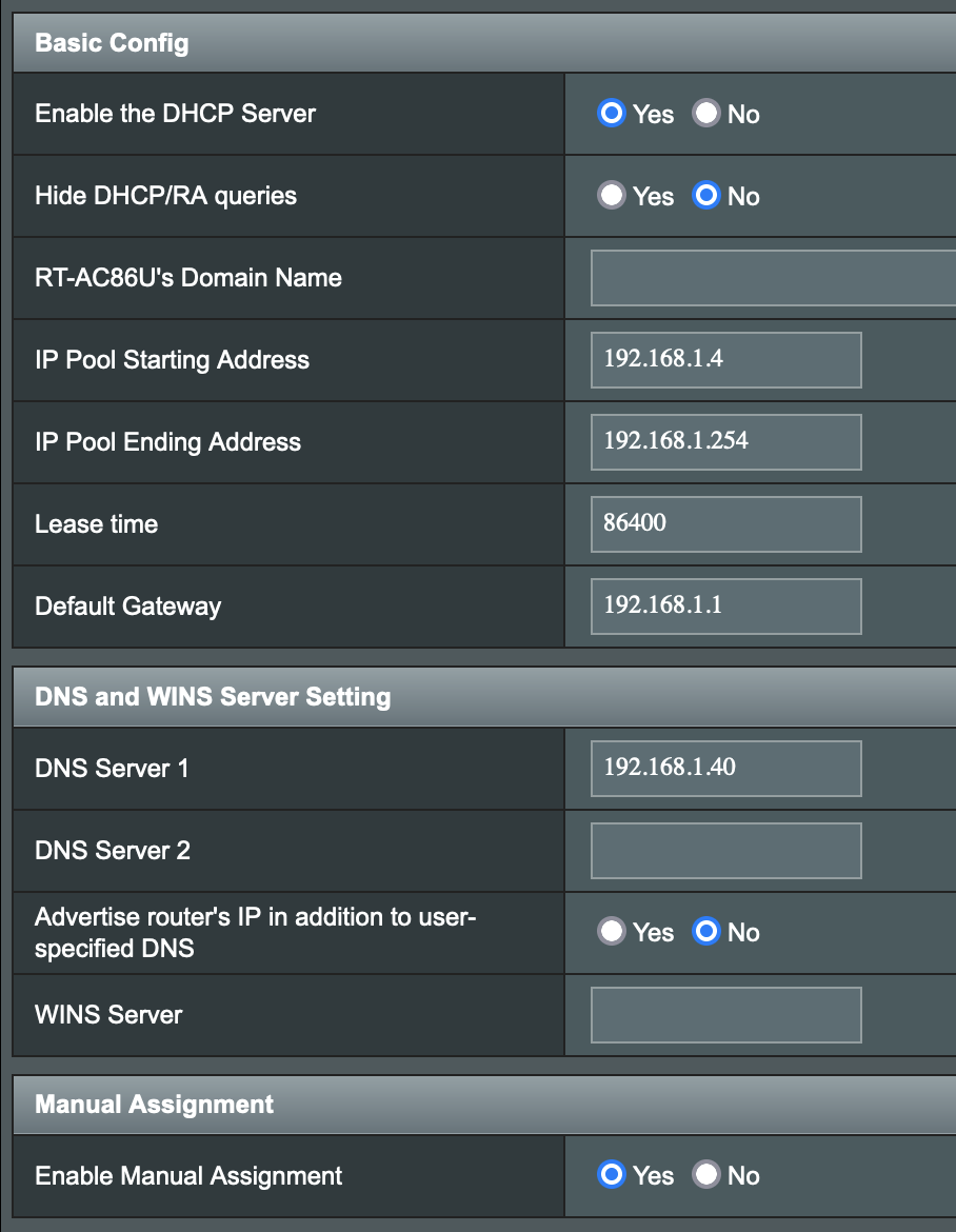

The Default Gateway field is blank in your screenshot. It should have the IP address of the router, so the DHCP server can tell clients to use the router to access external addresses. Edit it to be the address of the router, and disconnect and reconnect your clients (including Pi-hole) from the network to pick up the new details (a quick way to do that is reboot the router after making sure the gateway setting has been saved).
I'm confused why the default gateway would be a problem---doesn't this just dictate how external sources are routed when they connect to your LAN?
I did give it a shot but I still have the same issue.
Just to confirmthat 192.168.1.1 is indeed the router address, as I can ssh into it.

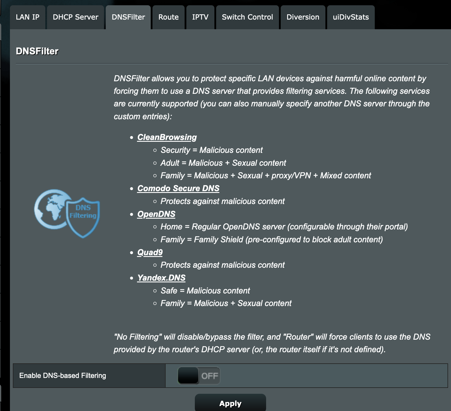

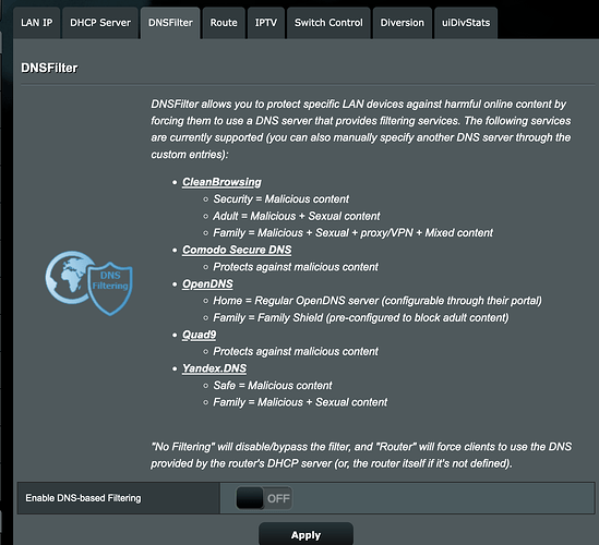

I found the culprit! It was this option in my router firmware:
Disabling this did the trick. It works now beautifully.
