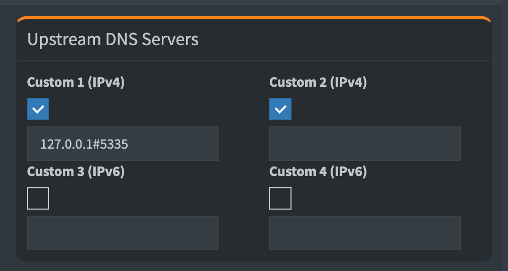

No, I meant in Pi-hole's Settings > DNS page, which is what I assumed you were referring to in the opening post when you mentioned changing them from Unbound to 1.1.1.1 as a workaround.
OK. Did that (the file dhcpcd .conf still has my changes above though) and my Internet went dark.
Only when I changed it to a public DNS did it work again.

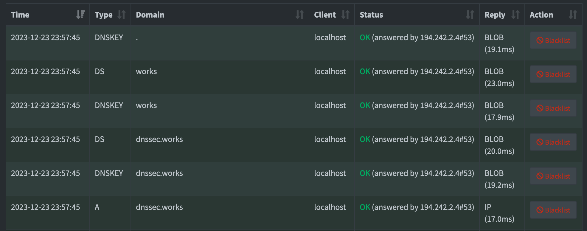

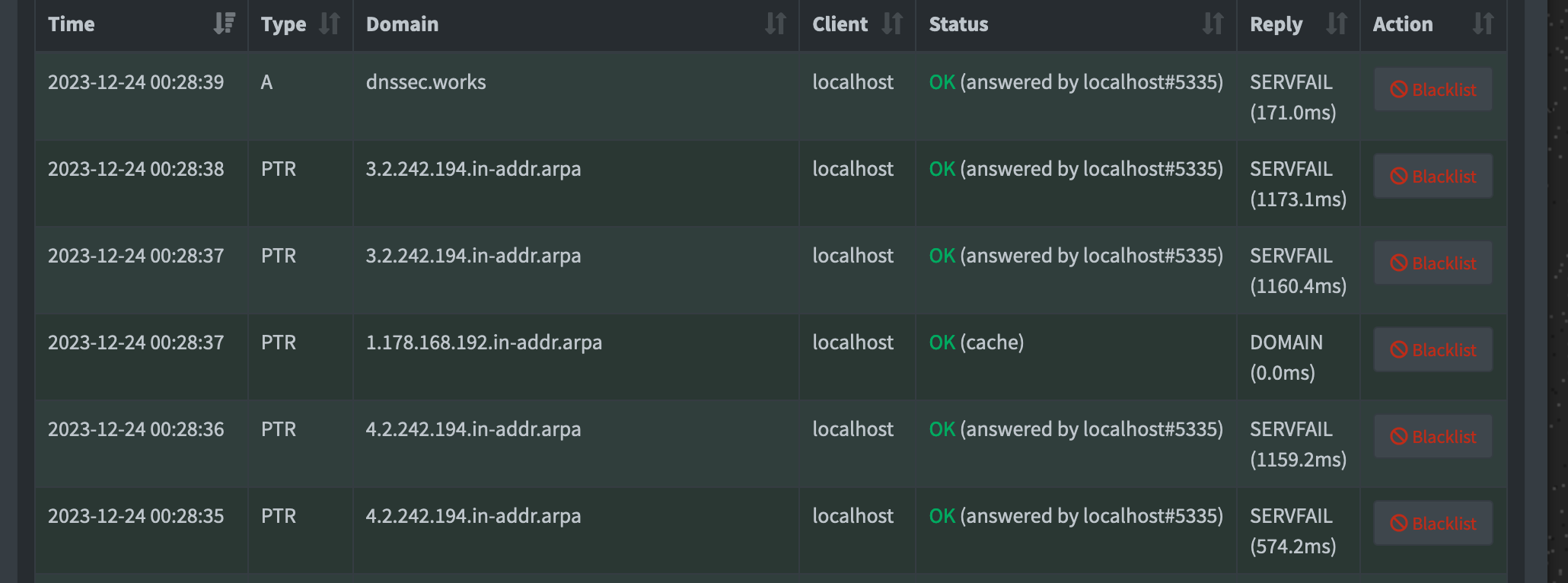

The purpose of that test is to review the Query Log.
Presumably that still fails, since now you are asking Pi-hole and Pi-hole is asking Unbound. However now the Pi-hole Query Log will show the request. Do you see BOGUS , Retried , or anything else of interest related to that dnssec.works domain?
Btw since I have Internet again (with the public DNS) I pulled a log and uploaded it here https://tricorder.pi-hole.net/o2Qu9aIM/ :slight_smile:
Oh right sorry! I changed it back, executed and took a screenshot:
