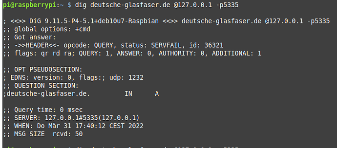

SERVFAIL with deutsche-glasfaser.de

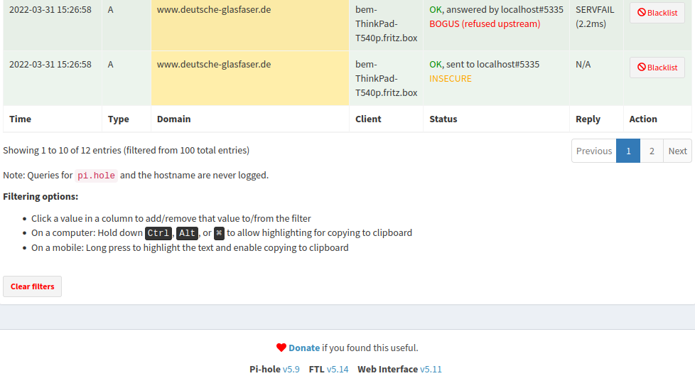

My pihole cannot resolve deutsche-glasfaser.de. The result is SERVFAIL. Please see the screenshot. This is the only domain that doesn't work with my installation. I have DNSSEC enabled and I am using unbound. Does anyone have an idea why this only doesn't work for this one domain?
Your screen capture shows that the query was refused by your upstream DNS server, which in this case is your local unbound instance. That's where the problem lies.

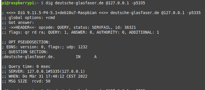

Are you able to query unbound directly and receive a reply?
dig deutsche-glasfaser.de @127.0.0.1 -p5335
Thank you for your quick reaction! A direct query shows the following replay:
I have also switch on the logging for unbound and added the files.
log unbound verbosity 5.txt (166.1 KB)
log unbound verbosity 3.txt (5.1 KB)

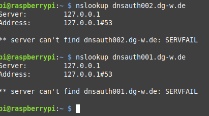

I have similar issues with .de domains throughout the past month but haven't found the time to properly troubleshoot this. I never visited deutsche-glasfaser.de but other domains such as aldi-sued.de failed reliably with SERVFAIL, too.
FWIW, I did just try both deutsche-glasfaser.de as well as aldi-sued.de and both worked just fine this morning.
The interesting part from your logs is (verbosity 3):
[1648744447] unbound[8491:0] info: resolving www.deutsche-glasfaser.de. A IN
[1648744447] unbound[8491:0] info: resolving (init part 2):  www.deutsche-glasfaser.de. A IN
[1648744447] unbound[8491:0] info: resolving (init part 3):  www.deutsche-glasfaser.de. A IN
[1648744447] unbound[8491:0] info: processQueryTargets: www.deutsche-glasfaser.de. A IN
[1648744447] unbound[8491:0] debug: out of query targets -- returning SERVFAIL
[1648744447] unbound[8491:0] debug: return error response SERVFAIL
The SERVFAIL is sent after 10 seconds.
out of query targets -- returning SERVFAIL typically means that the forward destination was not reachable, either because it was down or because it was blacklisted in some firewall, etc.
The verbosity 5 log is somewhat different. It logs that it was able to get the addresses
[1648746268] unbound[9481:0] debug:    ip6 2a00:6020:200::2 port 53 (len 28)
[1648746268] unbound[9481:0] debug:    ip4 185.22.45.49 port 53 (len 16)
[1648746268] unbound[9481:0] debug:    ip6 2a00:6020:100::2 port 53 (len 28)
[1648746268] unbound[9481:0] debug:    ip4 185.22.44.49 port 53 (len 16)
but was still waiting for additional records at the time you restarted the service (52 seconds after startup). You shouldn't have received SERVFAIL as a reply in this test but dog should still have been waiting.

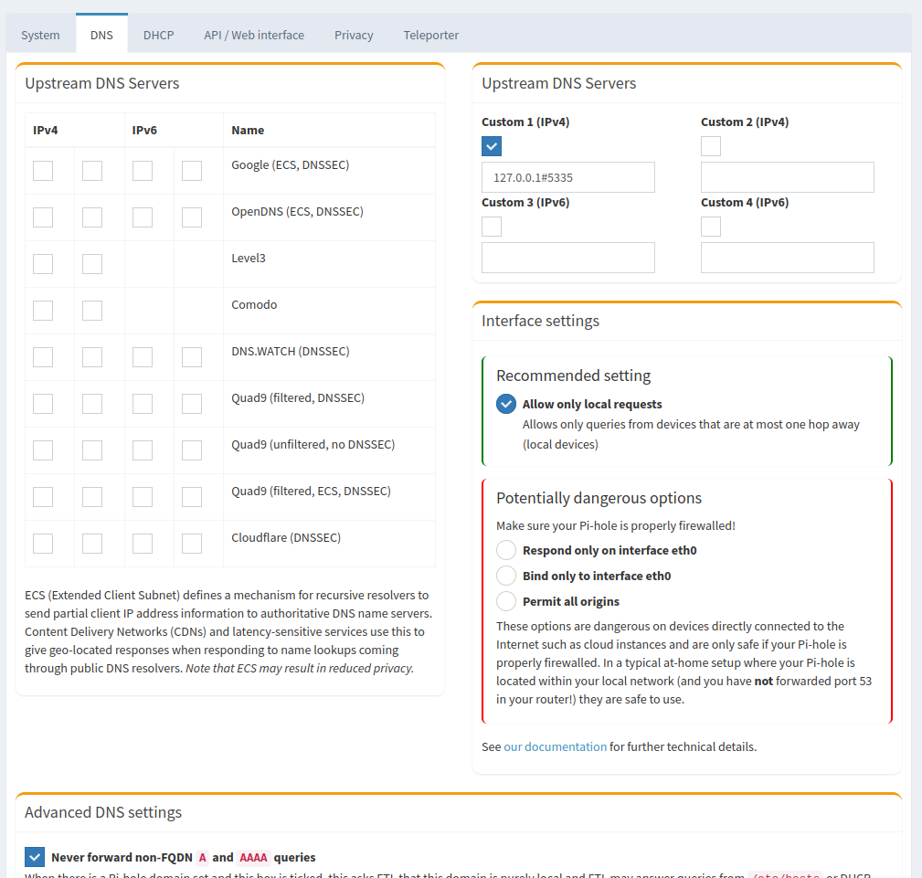

How does your unbound configuration look like? Is it the one from the Pi-hole documentation or did you follow some other tutorial and/or made changes yourself?
I just tried out deutsche-glasfaser.de and aldi-sued.de. aldi-sued.de works and deutsche-glasfaser.de continues to deliver a SERVFAIL
The unbound configuration corresponds to that described on unbound - Pi-hole documentation with one exception. I have root-hints enabled. The file is updated monthly and is currently as of March 16, 2022

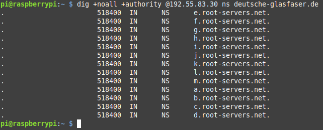

Let's ask one of the DNS root servers (192.55.83.30) which DNS server is authoritative for deutsche-glasfaser.de.
Run from your Pi-hole machine, what's the output of:
dig +noall +authority @192.55.83.30 ns deutsche-glasfaser.de
The answer ist as follows:
That looks ok.

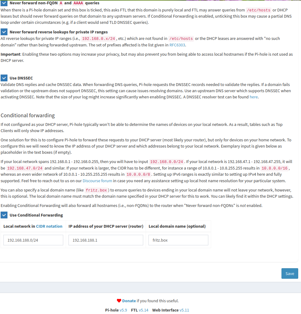

i have pihole + unbound too, but i don´t use DNSSEC and deutsche-glasfase.de is working fine.
Did you try to disable DNSSEC and try again?

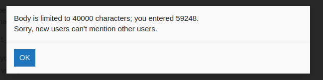

Thank you all in advance for your support.
I got the following error massage when it tried to post the output here in the same way as you did. So I put everthing in a Textfile.
OutputDebugUnbound.txt (57.8 KB)

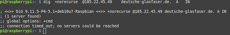

pi@ph5b:~ $ dig  +norecurse  @185.22.45.49    deutsche-glasfaser.de.  A   IN
; <<>> DiG 9.16.22-Raspbian <<>> +norecurse @185.22.45.49 deutsche-glasfaser.de. A IN
; (1 server found)
;; ->>HEADER<<- opcode: QUERY, status: NOERROR, id: 65479
;; flags: qr aa; QUERY: 1, ANSWER: 1, AUTHORITY: 0, ADDITIONAL: 1
;deutsche-glasfaser.de.         IN      A
deutsche-glasfaser.de.  86400   IN      A       185.22.44.179
;; Query time: 19 msec
;; SERVER: 185.22.45.49#53(185.22.45.49)
;; WHEN: Tue Apr 05 14:24:09 CEST 2022
;; MSG SIZE  rcvd: 66

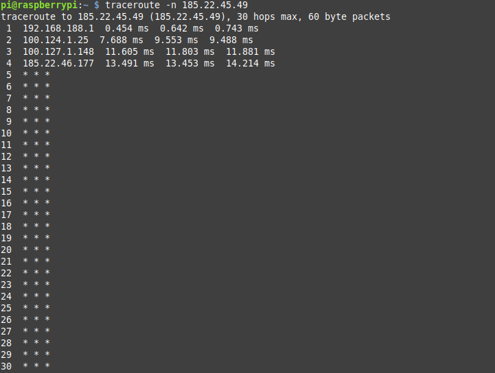

How does a traceroute look like?
pi@ph5b:~ $ traceroute -n 185.22.45.49
traceroute to 185.22.45.49 (185.22.45.49), 30 hops max, 60 byte packets
 1  10.0.0.1  0.824 ms  0.599 ms  0.616 ms
 2  192.168.2.254  1.353 ms  0.729 ms  0.770 ms
 3  195.190.228.154  13.081 ms  12.432 ms  12.296 ms
 4  * * *
 5  * * *
 6  129.250.2.232  23.361 ms 129.250.2.162  13.557 ms 84.116.135.33  6.211 ms
 7  84.116.135.34  6.304 ms  14.033 ms 129.250.7.87  8.873 ms
 8  130.117.14.1  8.922 ms  8.892 ms  9.014 ms
 9  62.115.120.228  13.059 ms 130.117.0.122  16.610 ms  16.150 ms
10  130.117.0.2  15.953 ms  15.913 ms  26.858 ms
11  62.115.38.13  15.538 ms  15.653 ms  15.472 ms
12  * * *
13  * * *
14  * * *
15  * * *
16  * * *
17  * * *
18  * * *
19  * * *
20  * * *
21  * * *
22  * * *
23  * * *
24  * * *
25  * * *
26  * * *
27  * * *
28  * * *
29  * * *
30  * * *

Looks like something is blocking DNS trafic (53 UDP/TCP) upstream to that 185.22.45.49 IP.
Could ask your ISP for assistance.

~$ nslookup dnsauth002.dg-w.de
Server:         192.168.178.28
Address:        192.168.178.28#53
Non-authoritative answer:
Address: 185.22.45.49
Address: 2a00:6020:200::2
What does above nslookup return for you?
