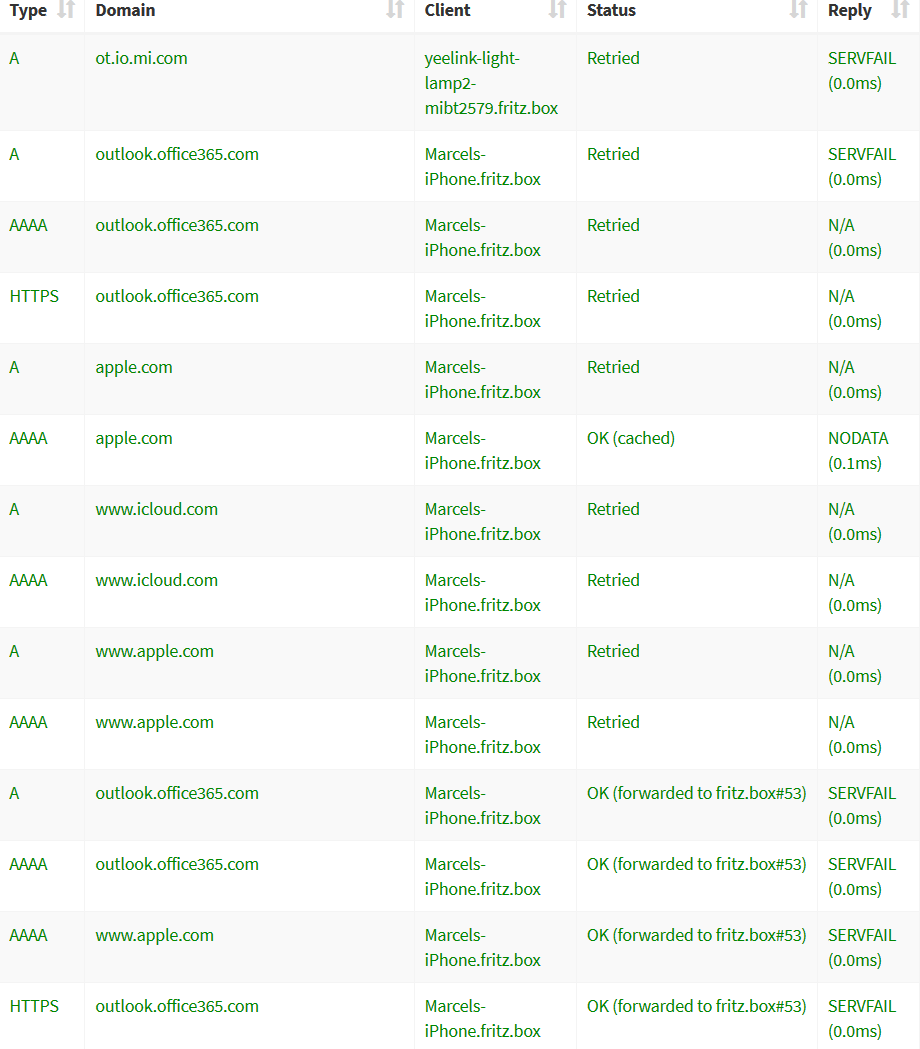

Ich hole das ganze nochmal hoch, da ich leider weiterhin starke Probleme mit PiHole habe. So schlimm, dass ich aktuell ohne arbeiten muss. Leider bekomme ich weiterhin zig "SERVFAIL" oder "N/A" Meldungen:
Leider kommen die Meldungen einfach random. Google funktioniert aktuell z.B.. Dafür macht O365 Probleme.
DNS-Server auf der Fritz!Box wurden auf Standard gestellt (also Provider-DNS). Pi-Hole ist aktuell und System auch, gebootet wurde auch einmal. Ich weiß nun echt nicht mehr weiter...

Your Pi-hole is using the router as the upstream DNS resolver. Change this to a third party DNS server and see if the problem resolves.

Hi, that is an intended setting. I want my router to make the DNS requests since I want to have the device names in the network overview of my router, using "*.local" names and want to use DNS-over-TLS. Is that not a recommended setting?
As mentioned: I do not have any problems when using my router as the DNS-forwarder. Works instantly.
@jfb Okay since this seems to not work stable I configured unbound which is asking the root DNS servers. Only change I did is to enable and prefer IPv6. Seems to work now, even with IPv6.
Why isn't this working correctly with my router as an upstream DNS server? Sometimes it works, sometimes not. This was running fine for a year or so.
Since I can't use DNS over TLS with them I, do I have any disadvantages in terms of security now? That shouldn't be the case because I am asking the root servers directly, without any other 3rd party DNS server, right?
