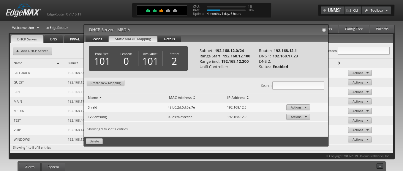

Multi VLAN network.
The Media player is on a separate VLAN to most other machines.
DHCP is done by a Ubiquity Edge router.
As stated, I am just curious why I am not seeing the NAME but am seeing the IP address instead.

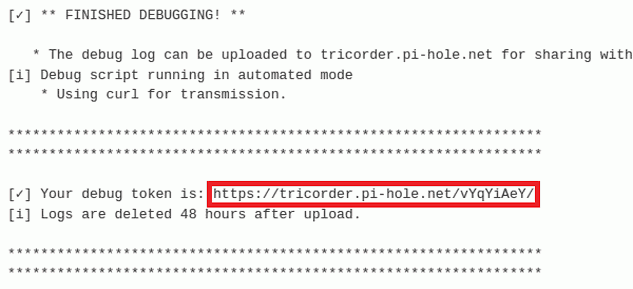

And please upload a debug log and post just the token URL that is generated after the log is uploaded by running the following command from the Pi-hole host terminal:
Tools > Generate Debug Log
(Sorry it took so long.)
Log - attached.
I hope I did it right.
Oh, IP number:
I have the DHCP server set to assign the same IP address to it, so I would hope that is happening.
Annoying that when I click the upload button and scan for the LOG file, those kind of files are NOT shown and so I have to rename it.
When it was being made I did also see a bit of red text - problems?
I'll look at the file myself, but if you notice anything else of concern, please let me know.
(Moderator edit: explicit debug log removed)
For your own privacy and security, do not post your debug log publically.
We've been through this a few times with you already:
We would require only the debug token as shown at the end of the process when you allow uploading:

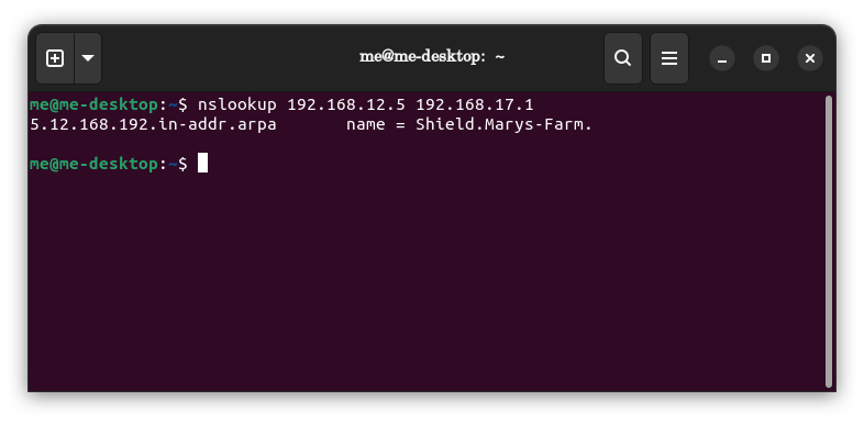

Substituting <shield.ip> with that IP address of your NVIDIA shield, what is the output of
nslookup <shield.ip>
nslookup <shield.ip> 192.168.17.1

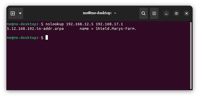

nslookup 192.168.12.5 192.168.17.1
5.12.168.192.in-addr.arpa name = Shield.Marys-Farm.
IP reversed.
That doesn't seem like the full output, and it is also just the output from one of the commands.
Well, that's what I typed and what I got back.

That's still only one command outpout.
It looks ok - your router is able to provide a name for your shield's IP.
How about the other command's output?
