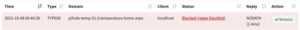

These queries should be blocked with a Blacklist regex, and they use home.arpa just in case. Be sure to create a Blacklist regex for
^.*temperature\.home\.arpa$
Run the script manually or via cron as needed, eg every 1 minute.
The Query log entry shows as a TYPE66 query for the domain pihole-temp-<temperature>.temperature.home.arpa
The Dashboard Query Types collates these under OTHER.
