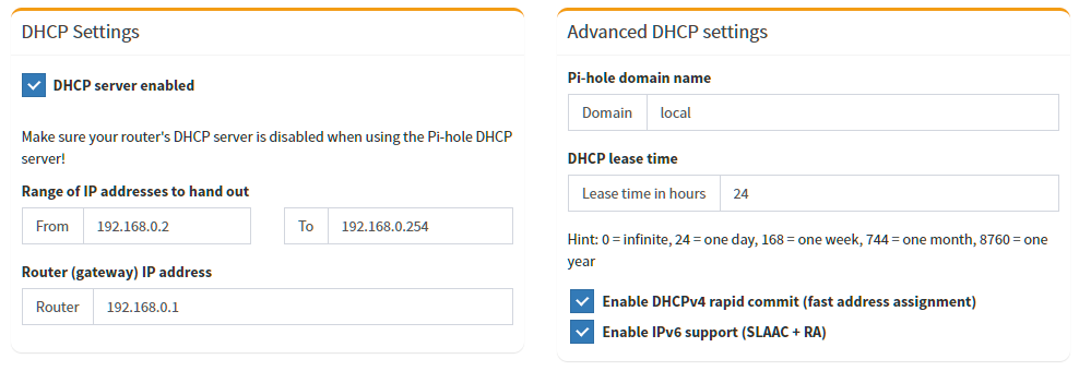

My network begins with my ISP router, which I'm afraid I'm not allowed to change. It does come with some settings, but won't allow me to configure a dedicated DNS. I have therefore disabled the DHCP in the router settings and enabled the DHCP server in the pihole configuration, following the manual.

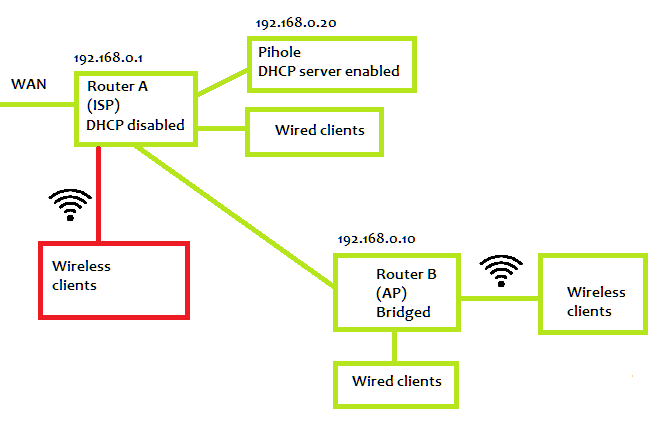

I have a second router wired to my ISP router, located in a different area. It's emitting a wifi and set to bridge all traffic to the ISP router. So on my ISP router, all clients coming from this connection look wired. For all of this, pihole works as I'd expect.
My ISP is also emitting a WiFi. When I try to connect to it, it looks like the client is not receiving an IP address and therefore, no network access is possible (tried with Android & MacOS). I also tried manually assigning an IP to the client, but network access remains unavailable. I remember from my university days that DHCP over WiFi is not as straight-forward as ethernet, but haven't found any further help on the internet so far.
Of course, I can connect with both clients using the AP WiFi and they will connect just fine. I assume this is because to my ISP router, they now look like a wired connection.
Here's a crude image of my network topology to maybe understand the issue better. I'm also happy to post log outputs from my Mac, if there's any commands which might help in finding the cause.

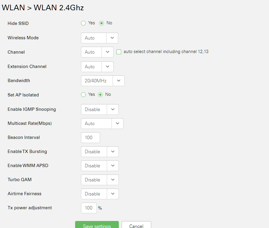

I also had the assumption that it's about the WiFi being put into its own zone/domain. I tripple checked the router settings and there's nothing that indicates this is happening - the opposite actually is the case (with AP isolation being turned off).

The last straw that I can think of is the domain name set on the pi-hole:
There is no way to set a domain on the router if I disable the DHCP server component there. Maybe WiFi clients trying to connect will be on a blank domain instead and therefore unable to communicate with the pi?
I tried blanking the domain on the pihole, but apparently this setting is not supported. I'm pretty much out of ideas at this point, any further hints or suggestions are always welcome.
Edit: A quick search has brought up this lovely PR though: https://github.com/pi-hole/pi-hole/pull/1150 I will try and set the domain name to none, maybe it helps.
The domain name has no bearing on your issue.

I do have a guest wifi spun up with this router as well, but that's not the one I'm connecting to - I would understand the isolation if I was within the guest network.
Unfortunately, the wifi settings are not very detailled on the ISP router web UI.

AP client isolation probably means wifi clients won't be able to talk to each other. Look for a separate advanced wifi option labeled client isolation or similar. You may want to consult your router's documentation sources for further details.
