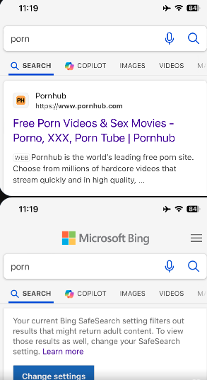

All other apps use Pihole because I use a test site to see if the ads are blocked or not. Also, Google and Bing have SafeSearch enforced no matter which browser I use.. FireFox, Brave.. you name it. Only when Using Safari and specially using it's Private Mode, it bypasses Pihole because Bing stops using SafeSearch therefore displaying adult photos... whereas when it's using Pihole, that is blocked.
When using Bing safesarch, it will not allow to change the setting... once I see I can change the safesarch from Moderate to Strict or None, it means it's not using Pihole anymore.

I've been playing with Safari more.. I thought it was when using Private Mode...but I now realize is when I Clear History and Website Data and go back to Safari, that first instance of using it, that's when it bypasses Pihole.... this is very strange behavior.

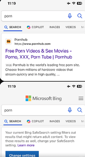

Here is a screenshot of 2 instances of using Safari.. the first one on top, is right after Deleting Data from settings.. the 2nd on the bottom is when I delete the tab and search again which is when Pihole is being enforced with SafeSearch.
This only happens right after I Delete Data and use Safari the first time after that. Once I delete the tab and search again, it goes back to using Pihole.
