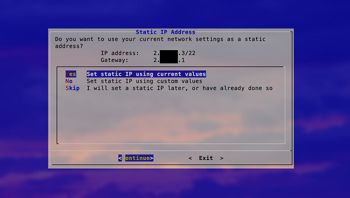

I’m currently working on setting up an RPi to take over routing duties. I have two interfaces - eth0, with static IP of 192.168.0.1, which is the lan, and eth1, which is connected to DSL and manages the wan. The RPi is using firewalld for NAT and isc-dhcp-server for DHCP. eth1 is not running via another router, it’s connected to a modem in bridge mode.
When running the setup, when I select eth0 as the interface to listen on, it should pick up 192.168.0.1/24 as the IP. I’m not sure what the gateway would be as eth0 has no gateway - it handles internal lan traffic only.
When I select eth0 as the interface, the Pi-hole setup wants to use the wan IP on eth1 as the static IP. If I change the IP and set the gateway to 192.168.0.1, when setup completes, eth0 has lost the 192.168.0.1 IP and no clients on the lan can see the RPi. Removing Pi-hole and rebooting the Pi gives the IP back to eth0.

Almost - the setup doesn't apply that selection, it rather makes a proposition for that IP that a user can accept or reject to go forward with, and it only does so on Raspberry Pi OS.
Did you try both options?

Whatever I enter for the gateway value here, when Pi-hole completes the install, eth0 has lost the 192.168.0.1 IP completely. At that point all clients lose connectivity to the Pi.

This is what I'm offered when I select eth0 as the interface for Pihole:

Above one looks wrong.
The static routers= line installs a default route.
But the nogateway directive conflicts because its there to not install a default route.
Also you can use the loopback IP 127.0.0.1 for the domain_name_servers= field instead of the eth0 IP 192.168.0.1.
That way local processes will use the loopback IP for DNS lookups instead of broadcasting the query on the eth0 interface.
Plus the loopback interface named lo is way faster as the 100/1000 mbit eth0 interface and not dependent on if connected or not.
Try fix this so it resembles below:
  static ip_address=192.168.0.1/24
  nogateway
Am not sure if you knew already but if you dont configure any IP details in dhcpcd.conf for the WAN interface eth1, the dhcpcd daemon will try acquire IP details, including DNS server(s), automatically via DHCP for this interface.
Default for dhcpcd is to acquire IP details via DHCPv4, and IPv6 SLAAC, for all detected interfaces except when configured otherwise (like static ip_address=).

To be clearer: Did you opt to NOT to configure a static IP when installing Pi-hole?
This fixed the issue. Thank you!

If it were my choice, I would have started of with pihole-FTL's own embedded dnsmasq for DHCP for simplicity ... KISS.
Only one daemon running instead of two.
You can always at a later stage decide to additionally install isc-dhcp-server if so required.
Also with pihole-FTL doing DHCP, you dont have to configure additional settings/hooks for the client hostnames that are advertised during the DHCP lease transaction to be registered automatically in DNS like you have to do with isc-dhcp-server.
You have not mentioned how these client hostnames are now registered in DNS?
EDIT: Ow and dnsmasq runs in more places than you think:
dnsmasq has low requirements for system resources,[6][7] can run on Linux, BSDs, Android and macOS, and is included in most Linux distributions. Consequently, it "is present in a lot of home routers and certain Internet of Things gadgets"[4] and is included in Android.[5]
For your specific configuration, I wouldn't think so.
In addition to what deHakkelaar already explaned, ISC DHCP would not register hostnames as proposed by clients during DHCP lease negotiation with a co-located DNS server by default.
dnsmasq -and thus pihole-FTL- happens to be both a DHCP and a DNS server and would do so automatically, i.e. it does create the necessary A and PTR records for a DHCP client. It would also make an effort to associate that name to certain observed IPv6 addresses, i.e. it would create the respective AAAA and PTR records.
This can partially mitigate IPv6's lack of hostname registration for certain auto-configuration procedures.
I'd support deHakkelaar's recommendation to make use of Pi-hole's DHCP server, at least for your current configuration.
I tried to anticipate that you would not stick with those eth0 clients, but you would want wifi clients to be able join your network as well. That's why I mentioned RaspAP as a possible configuration option.
But a router's duties and capabilities are not limited to DHCP.
If you'd want your RPi router to also handle stuff like VLANs, guest networks, home automation etc. etc., you may as well consider a full router OS like OpenWRT straight away.
Note however that OpenWRT would also employ dnsmasq for DHCP and DNS, and you'd have to research if and how that could coexist with or be replaced by Pi-hole on the same device. Other router OSs may pose similar problems.
If your main concern is routing, I'd probably focus on picking the optimal software support for that field of application first, and worry about how to integrate Pi-hole later.
