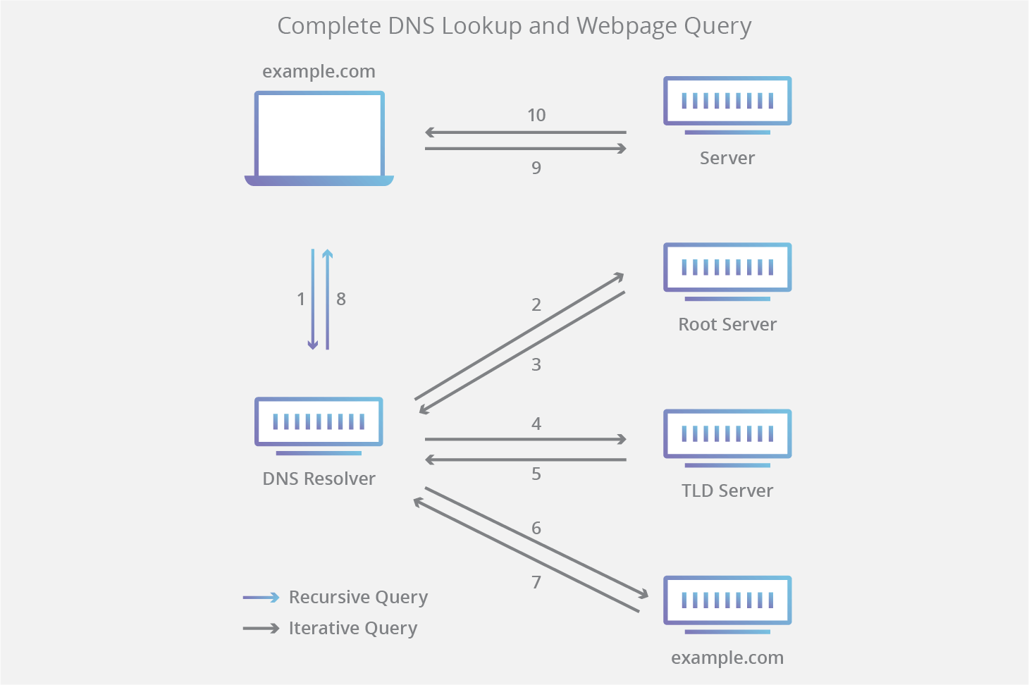

Either way you will get caching. The benefit of unbound is that it provides an authoritive answer for the domain by querying root sever, tld sever etc ( recursive dns lookups ) so you know the ip that it provides is the actual ip. Because the intial query has to go through these extra steps it takes longer but cached results going to be very fast as they come from pihole.
When you use something like cloudflare as your upstream dns server, it acts as a middle man but the result is still cached by pihole so its still going to be very fast.
So unbound gives you and authoritive answer and the cost of a slightly longer intial query time while a 3rd party resolver like cloudflare gives you faster inital resolve but you place your trust in them to provide the correct ip and to not misuse your data.
