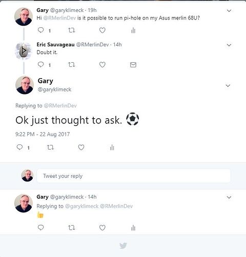

I tweeted Eric just the other day about he doubted it could happen.
Maybe it could on dual core ARM with at least 1Ghz and more ram than your a68u
