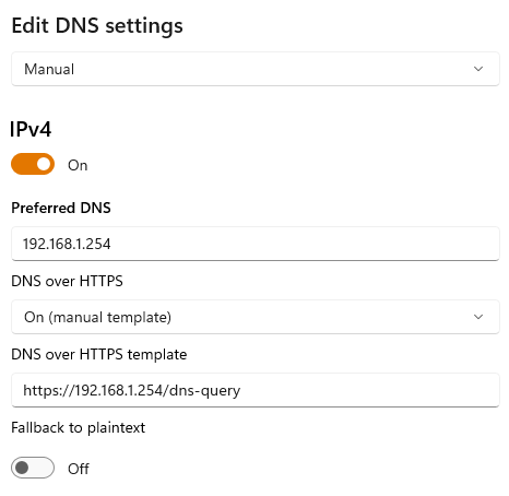

Set Windows 11 to use DoH:
(this took me far too long to figure out; couldn't find any clear instructions anywhere, either)
Network & internet > Ethernet --> "DNS Server Assignment" section

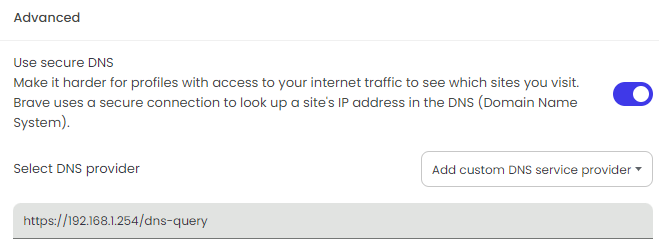

Set brave browser to use DoH
Search "dns" in settings, then configure a custom DNS provider:
