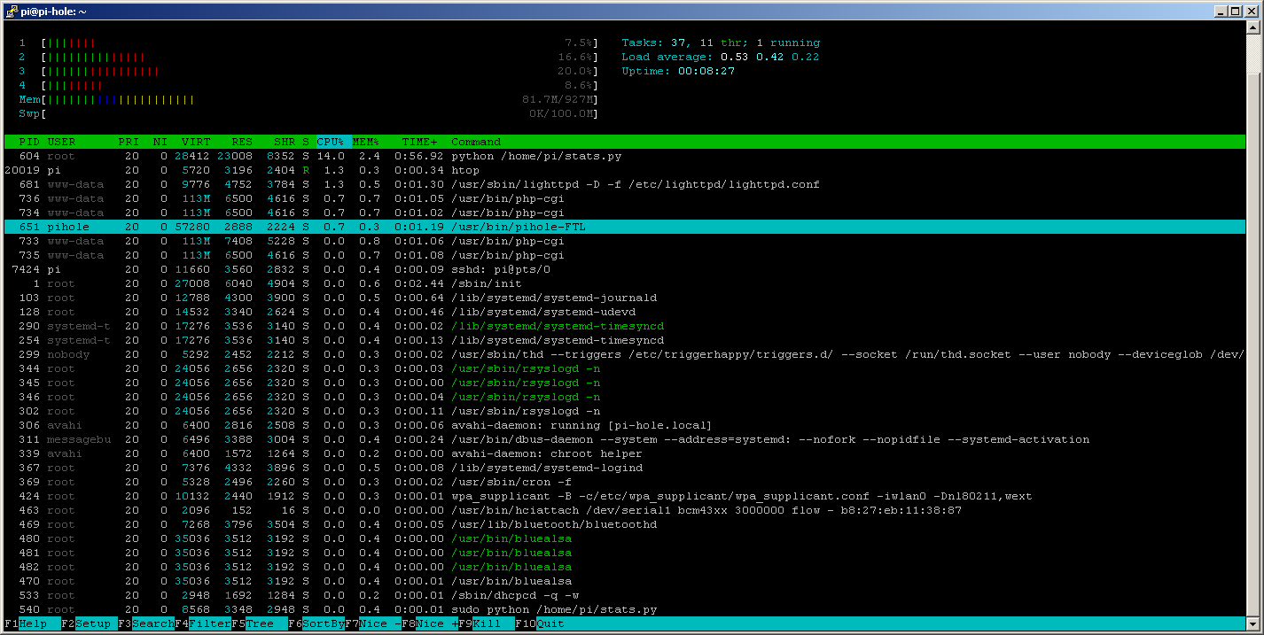

Could you show up the output of the command
uptime
and maybe also a screenshot of
htop
(You may need to install the latter with sudo apt install htop)
Maybe it's just a bad sample of the new Pi with bad RAM for example ?!
My Raspberry Pi 3B which consumes a bit less power than the new 3B+ says 56,9 Celsius at the moment and is located in a original Raspberry Pi case on top of my DrayTek 2860 router for about a year now without any issues! :wink:
uptime
17:50:25 up 12 min, 2 users, load average: 0.23, 0.39, 0.26
htop
This indicates that your system is mostly idle which is also confirmed by htop. So, it seems that such a temperature is norm for this device. Take into account that you still have a multi-core CPU running at more than one GHz without any active cooling! Mind that, in contrast to "regular" CPUs, iARM CPUs can easily go to temperatures well above boiling water (100*C, no idea what it might be in Fahrenheit) without any problems.
