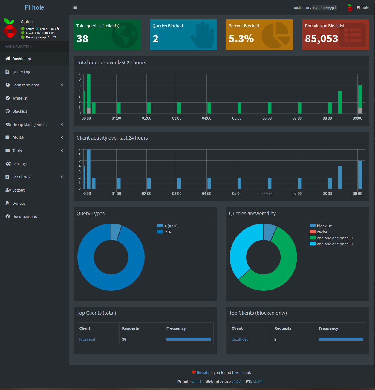

I had pi hole running on my network for over a year and had added a bunch of blocklists that no longer existed/they moved/I typed them wrong so I wanted to do a refresh. I did this by running pihole -r and choosing the the Reconfigure option. After doing this the backup DNS was being used (I assume this because the number of queries wasn't increasing). I noticed this:
[βœ—] No IPv4 address(es) found on the eth0 interface.
[βœ—] No IPv6 address(es) found on the eth0 interface.
[i] Default IPv4 gateway: 10.0.0.1
and assumed I had done something wrong during the setup and after finding no answers to fix this I formatted the pi and reinstalled raspbian.
After reinstalling pi hole I have the same issue. The IP of the pi is set as the primary DNS in the router's settings, I am able to ssh to it, and reach the admin console from a browser.

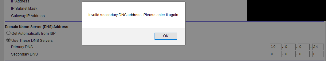

But connecting to the gateway fails. I haven't found any good information/don't know the search terms for the error I'm seeing.

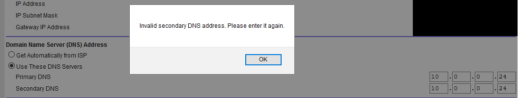

The secondary can't be 0.0.0.0 set the same IP (the one of Pihole) for primary and secondary.
I tired that as well, they thought of everything.
