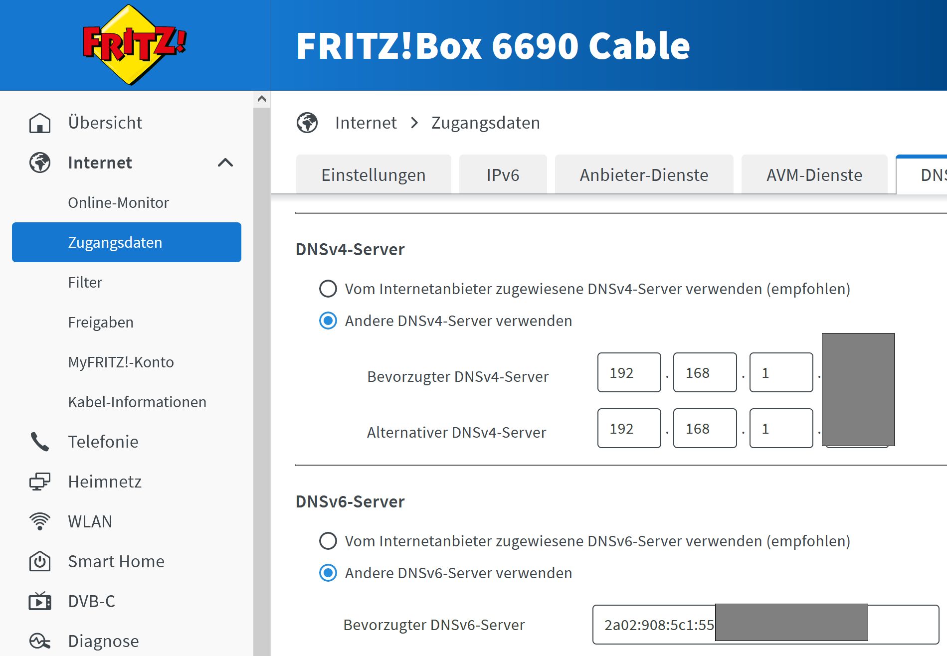

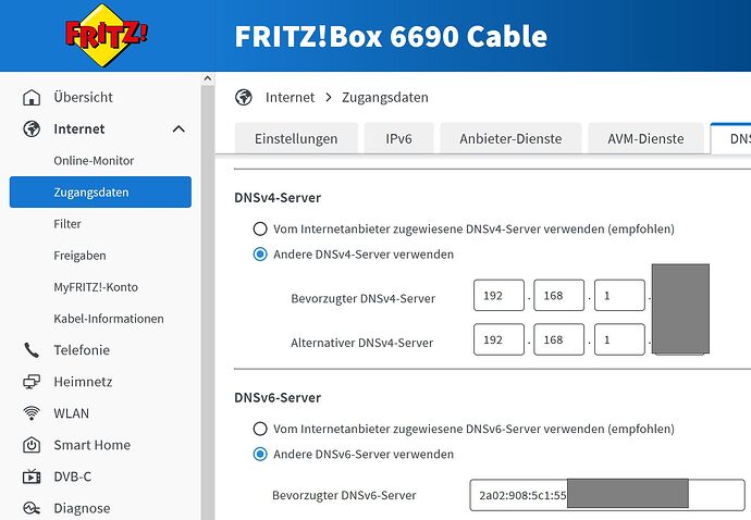

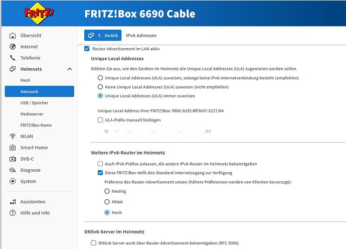

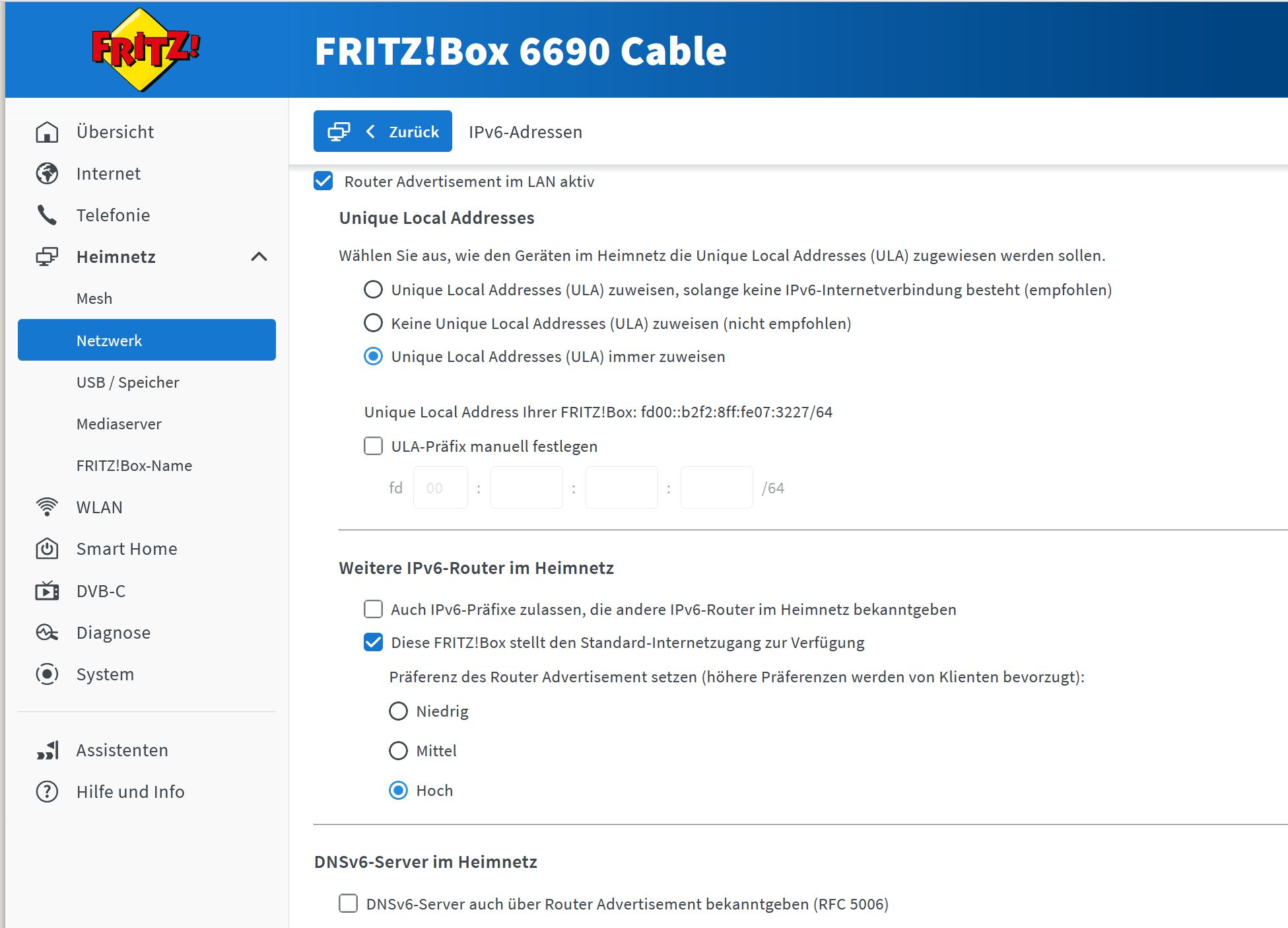

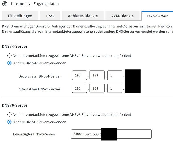

My router ist set like this:
and
The DNSv6 adress is wrong and advertisment ist currently disabled. Have to take care of that and the ULA setting is wrong. Have to find out how to correct that properly.
And if I get the term "upstream dns server" right: my pihole asks my local unbound server to resolve the DNS query. That's my setup so far.

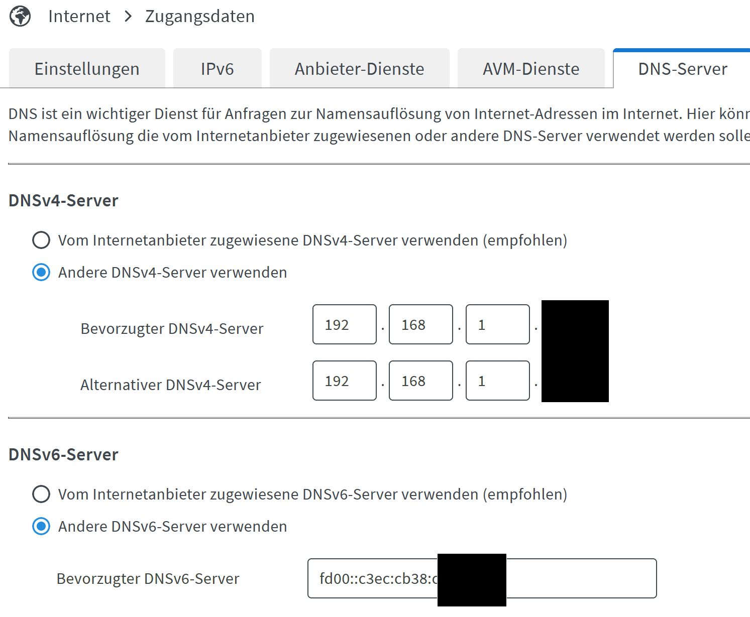

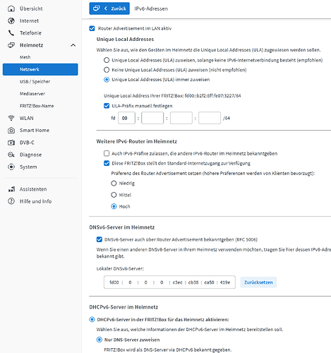

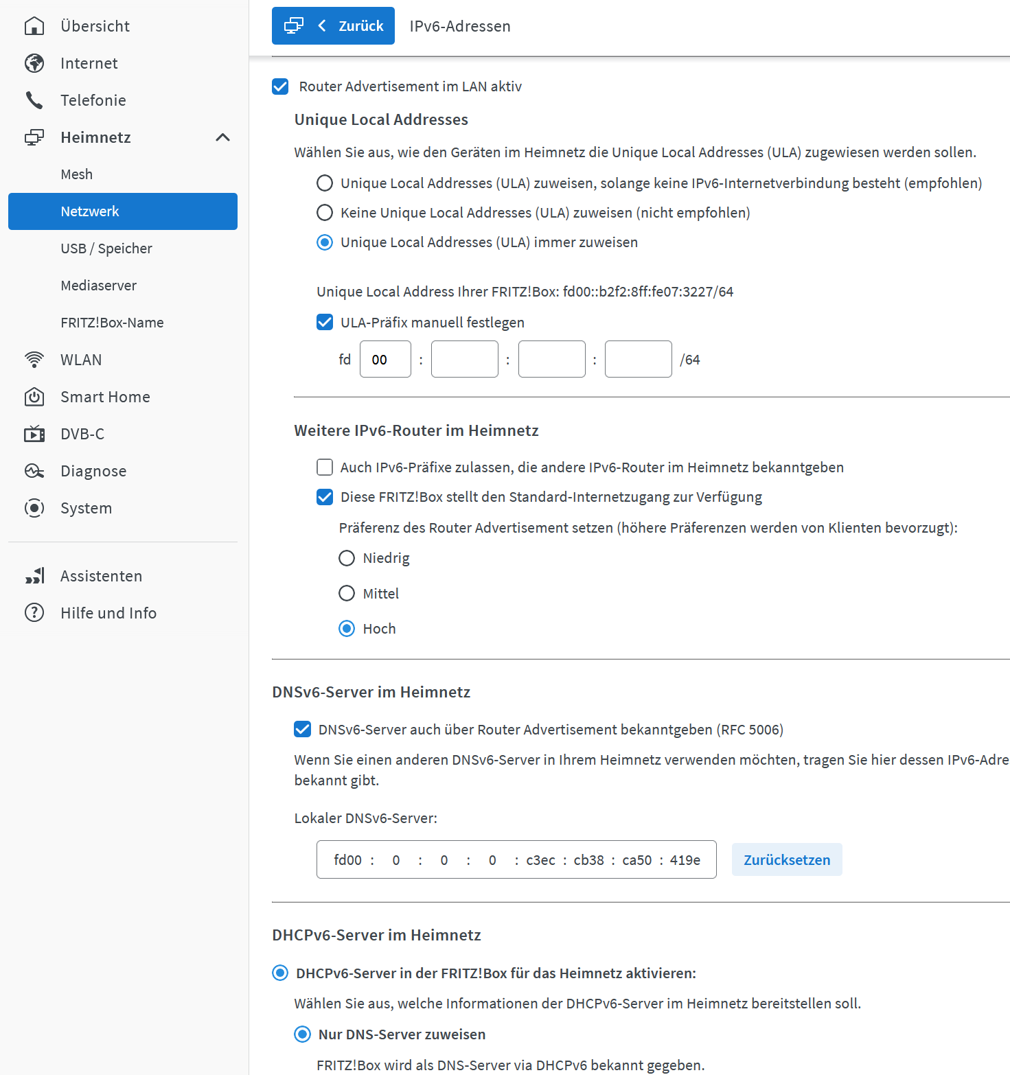

Update. Tried to understand DNSv6 setup.
Current config now:
Local DNSv6 Server address is the same as in the output of [ip -6 a] on Pi-hole.
Does that seem correct now?
