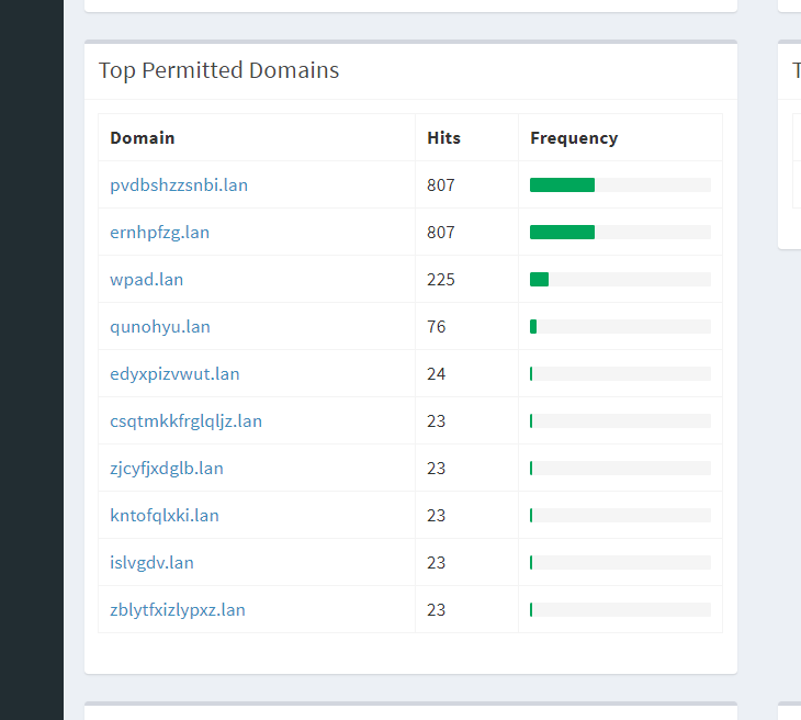

I've been in trouble for 3 days. The router sending many requests and the pi-hole does not work!
It asks for update but nothing changes. Make thousands of requests, what would that be? Can someone help me? DD-WRT usage

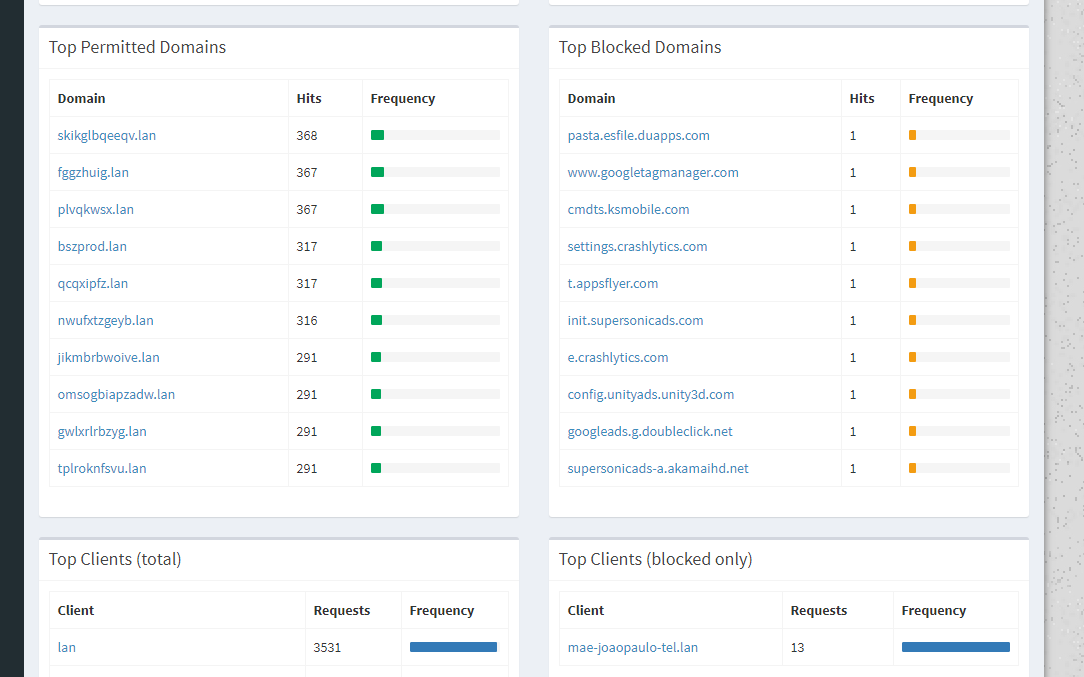

I took it today so I could "understand" this, but I could not. I formatted my pc, router, smartphone, but nothing worked. Finding out that this only happens when you enable Conditional Forwarding, these domains start popping up and locking my Pi-hole.

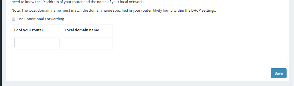

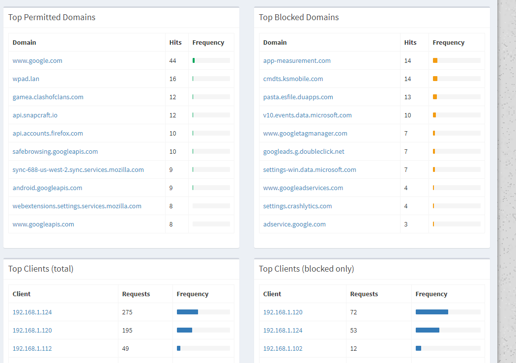

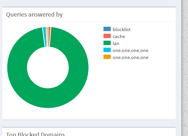

The problem starts when I enable Conditional Forwarding, I receive many requests per second from the router, and Pi-hole hangs, does not block ads at all, I'm sending an example of the disabled function, everything works fine.
Update 2
One thing I noticed. I use Windows 10 1903, if I enable the Conditional Forwarding function everything works perfectly, but if I "disable and activate the internet" starts those requests that hangs all my pi-hole
Pi-hole working with Conditional Forwarding disabled

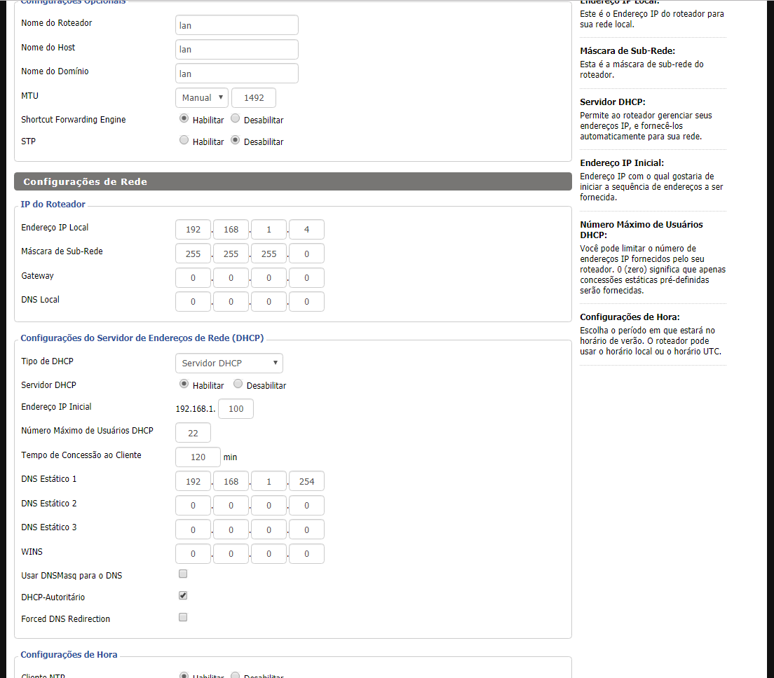

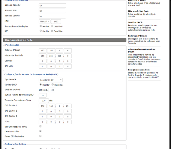

You most likely have a loop in your configuration. Conditional Forwarding should not point to a router that is set to use Pi-hole as it's DNS server. Why are you using Conditional Forwarding?
As a side note, Pi-hole can handle many, many more queries than you are sending to it, it will handle thousands of requests per second.

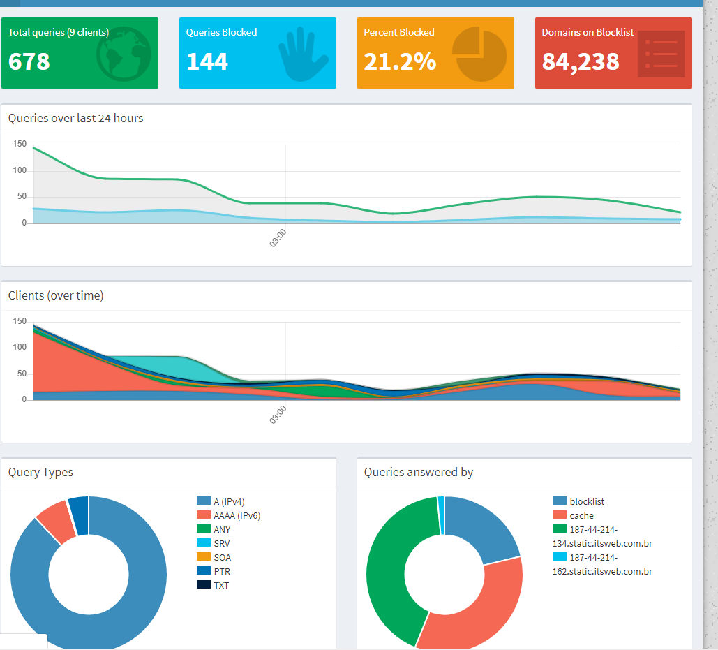

You also seem to be running an open Pi-hole on the net without any firewall blocking. I see that you show more than 150 clients in one of the screen captures. Please secure your Pi-hole, we do not provide support for open resolvers.
Here's one of the problems, running Pinhole in my house and I have no more than "150 clients" something happens to this and I no longer know what it is
I'm using Conditional Forwarding to be able to see the names of my devices, if I do not activate only the ips
Hi, I am able to change the names of ips through /etc/ hosts. Thank you
