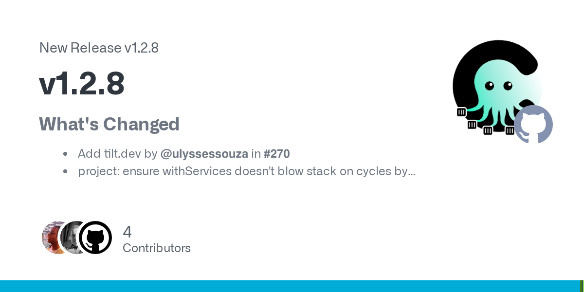

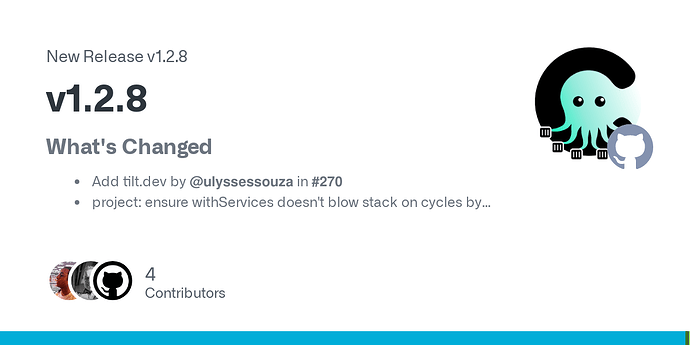

Maybe there is another possibility. Folks on docker realized that not having . is an issue and fixed it
https://github.com/docker/compose/issues/8862
and
This was part of compose-go v 1.2.8. (released 22/06/2022)
This component is included in docker-compose with v 2.6.1. (23/06/2022)
https://docs.docker.com/compose/release-notes/#261
So with a fairly recent docker version, this should not be an issue anymore.

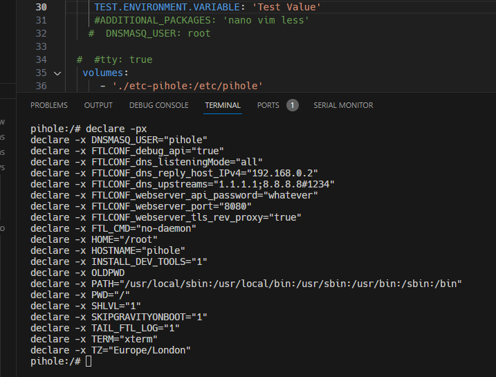

IIRC I could use them in the docker compose definition, but as soon as you start to try and access them in the shell, they get cut off at the first .
Hmmmm

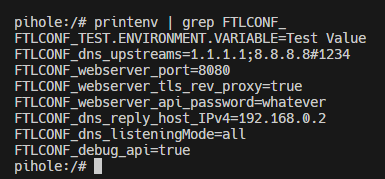

Although, we could use printenv instead of declare -px, which does show the environment variables that have a . in them.
