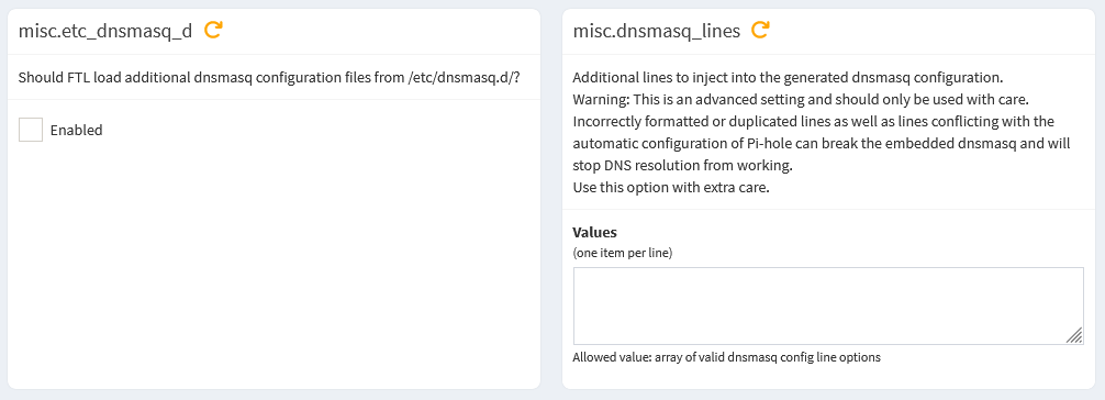

Once enabled with FTLCONF_misc_etc_dnsmasq_d="true" this should be handled somewhere.

If you add your changes to misc.dnsmasq_lines (instead of enabling misc.etc_dnsmasq_d), Pi-hole will reload the configuration automatically.
I saw that, however I did not get this to work from a docker-compose env var.
Seems to have trouble to double encode list items.
Can i just enter items one per line?
Plus it would probably overwrite changes to pihole .toml on the next restart, wouldn't it?

Example usage from the compose file:
environment:
      FTLCONF_misc_dnsmasq_lines: |
        server=/61.10.in-addr.arpa./127.0.0.1#953
        server=/example.invalid./127.0.0.1#953
        server=/else.invalid./127.0.0.1#953
        server=/domain.invalid./127.0.0.1#95
Once a config item is set via the environment variable it becomes read only, effectively locking it and ensuring a single source of truth.

It's doing this to hold the queries from the last 24h in memory to provide the dashboard graphs and the query log. You can disable import on startup with Settings > All Settings > Database > database.DBimport
This is not solving the problem...
I still argue, why is this so much slower than in v5? And why is there a reload for lists that works in the blink of an eye...
Hmmm
You need to provide more information. Setting the database import to false should speedup the startup - in your case by roughly 50 seconds
What I'm trying to say is, that the full cycle is worse than the service reload dnsmasq (config reload) in v5 and ask if it would be feasible to get this functionality back...
Why is the webserver including database in this cycle
