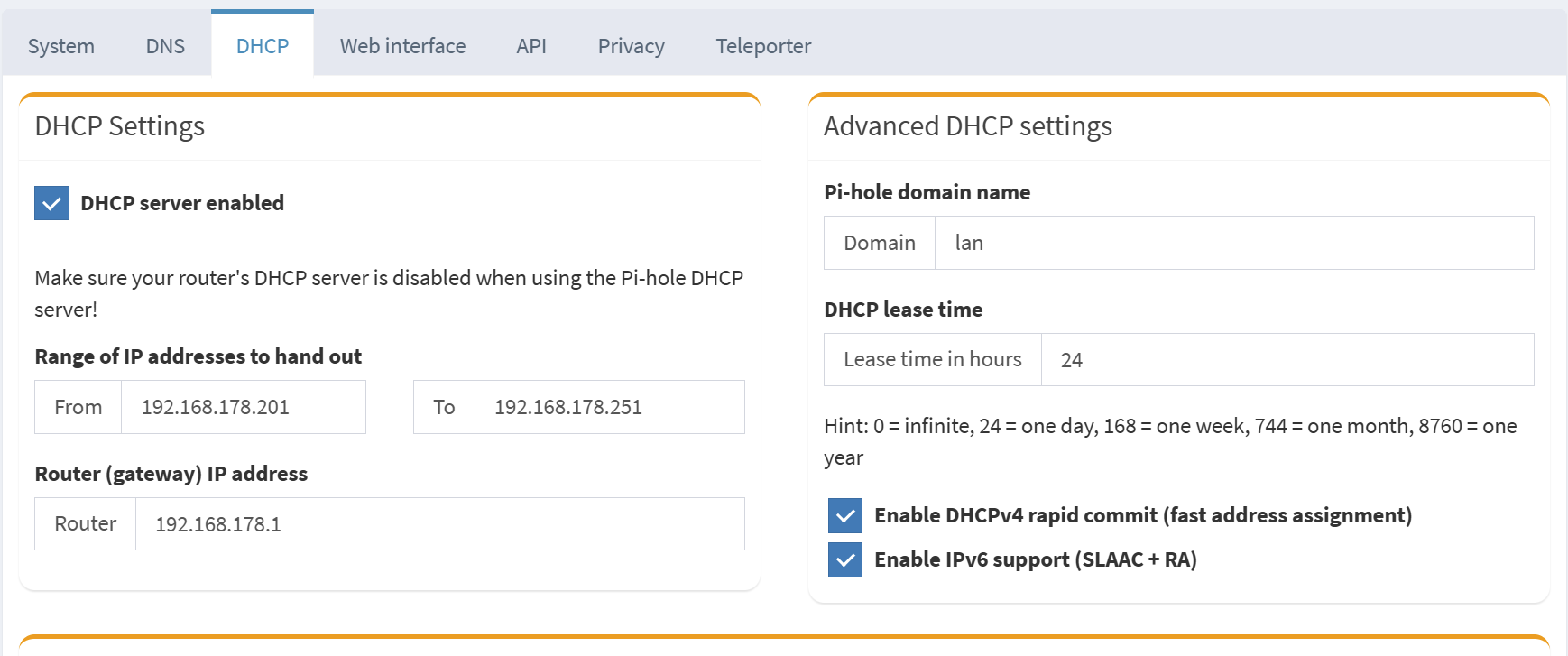

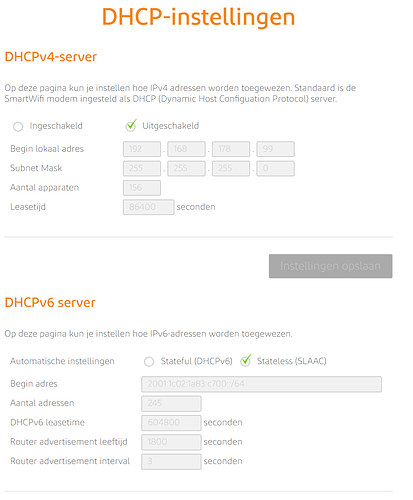

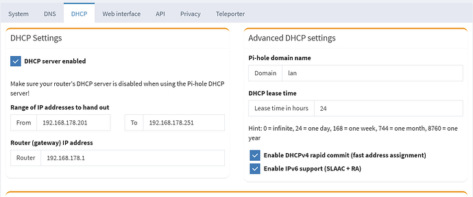

I just installed Pi-hole on a PI and configured it as DHCP and turned DHCP in my router off.

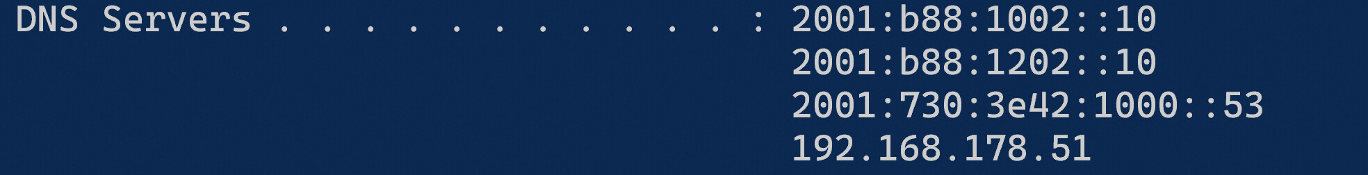

On my laptop I type ipconfig/all and I see it (192.168.178.51) popping up as DNS server:

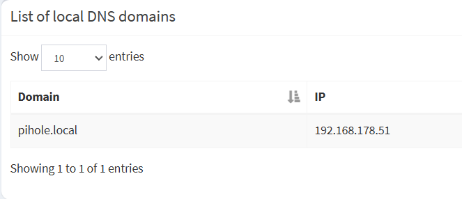

I now have added in "Local DNS Records" 1 line to check if i can resolve this pi-hole uhm pi itself:
  • domain: pihole.local
  • IP: 192.168.178.51

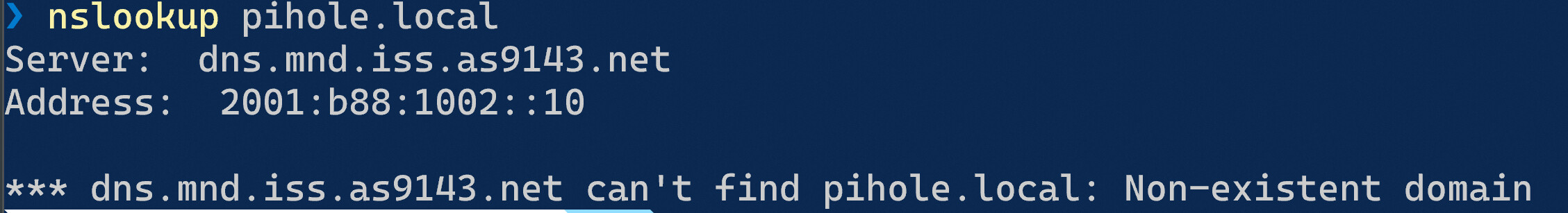

but it does not resolve, browser gives a 404 when using pihole.local/admin and nslookup gives : non existent domain

Pihole should be the only dns server in your list. The nslookup failed because it tried to resolve the name on the public network.
From the same client what do you get it you run nslookup pihole.local 192.168.178.51
Another note, avoid using .local as a search/suffix domain bc it conflicts with mDNS:

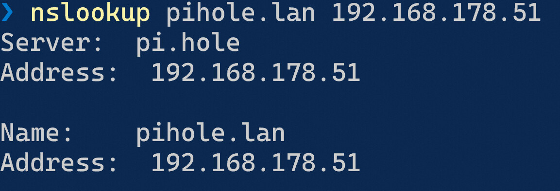

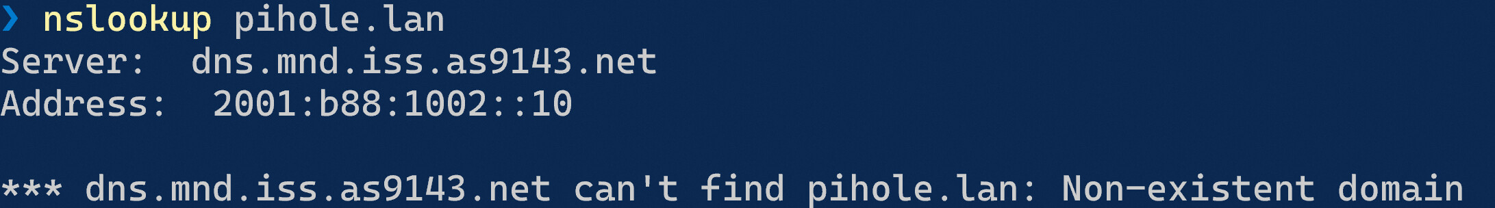

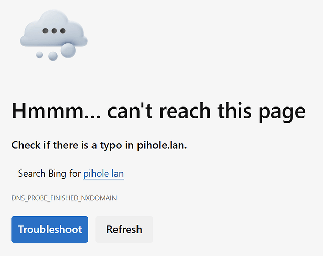

I changed it to pihole.lan

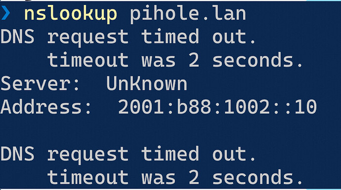

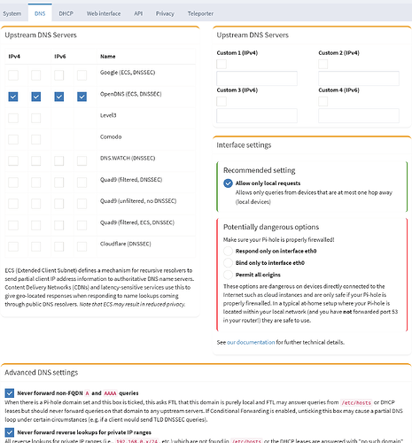

When you point your query to the pihole ( nslookup pihole.lan 192.168.178.51 ) it works as intended. When you don't it goes to an external dns provider which belongs to ZIGGO-INFRA / Vodaphone NL. ( 2001:b88:1002::10 ).
This would indicate a router setting where perhaps the router is not pointing to the pihole or perhaps the router is providing its own DNS servers in addition to what you set. Either way, I would look at your routers settings.

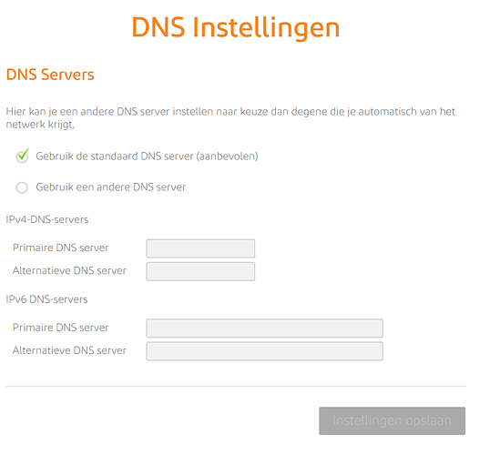

I could not change the DNS settings since it does not allow to add local adresses therefore DHCP route

Do you have an option to disable IPv6 on the router?
Preferably for the LAN side only.
Most of the times you wont need IPv6 and can do with IPv4 only.

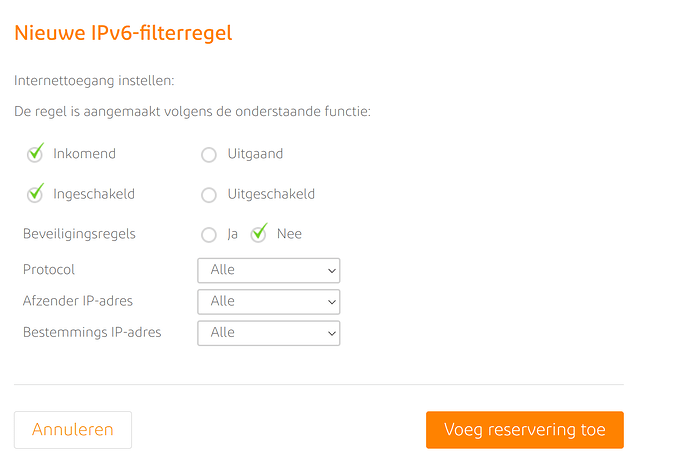

Looking at article you linked it sounds like one solution was to add IP Rules to block the IPV6 Traffic and force IPV4. I'm guessing thats what you mentioned did not work.

a. The router does not allow you to fill in any local IP4 addresses when choosing to set your own DNS servers so filling in the pihole server is not possible (c.q. changing this screen) or changing the DNS :
b. However ... since it does not matter which IP4 address you fill in here (because anyways the pi is the DNS server) you can fill in anything in these IP4 fields and then fill in the IP6 fields the values of the GUA (Gloal Unicast Address) of the PI. (run ip -6 addr show). So it is a counter intuitive trick :slight_smile:
(the GUA general remark on occasional loss when Ziggo changes and requires to reconfigure is a consequence but logical)
With this configuration it works, clients now get purely the pihole dns servers.
