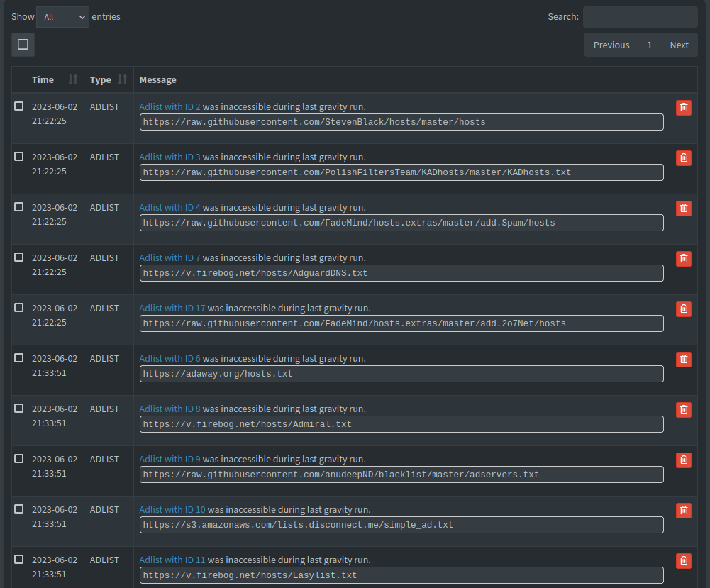

I have some issues with pi-hole at the moment, domain resolution issues like this

Do you think it's from upstream dns or I misconfigured something/pihole bug?

This happens with every update of the list, and also causes concern for other applications

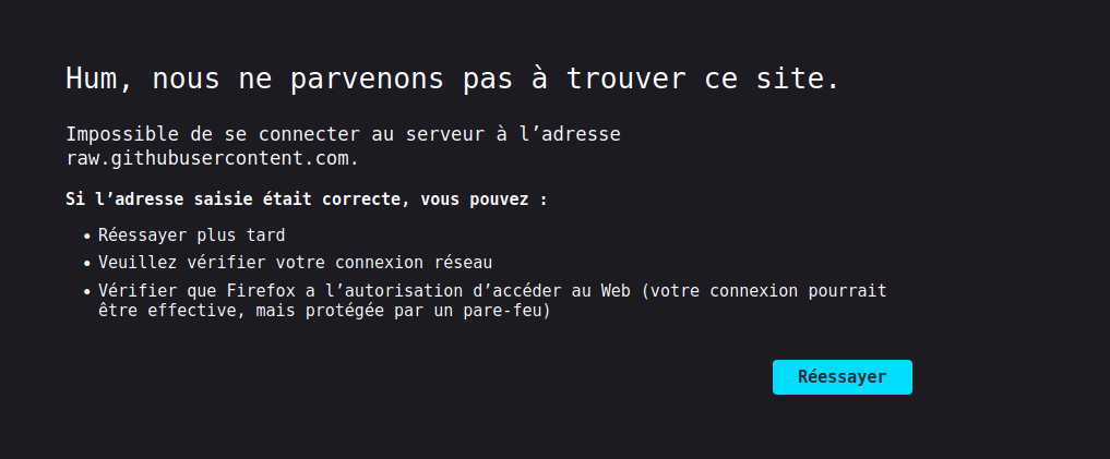

Are you able to access the lists using the browser?
I have this problem for a few weeks I have to restart gravity so that the missing lists are found, docker sometimes does not find github also
From the browser it goes like pi-hole, sometimes it's solved, sometimes not, I have to press "Réessayer" (Retry)
