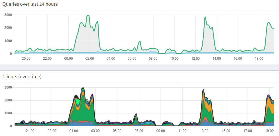

I know that it is every 12 hours because the DNS queries spike up in the PiHole interface due to some of my network devices constantly checking for an internet connection (mostly Google home and my work laptop).

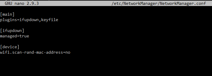

Do you have Network Manager installed?
check with which NetworkManager
If you do, then the culprit might be Network Manager and it's forced dnsmasq reload.
The dev brach requires dnsmasq to be disabled in order for FTLDNS to work.
If dnsmasq gets activated, it breaks FTL and no queries will go through.
In order to disable dnsmasq from Network Manager, you'd have to edit /etc/NetworkManager/NetworkManager.conf and comment out dns=dnsmasq
( sudo sed -i 's/^dns=dnsmasq/#&/' /etc/NetworkManager/NetworkManager.conf )
then restart the network manager and networking:
sudo service network-manager restart
sudo service networking restart
Kill dnsmasq sudo killall dnsmasq
and restart FTL
sudo systemctl restart pihole-FTL
It looks like Network Manager is installed but there is nothing in the config file related to dns.
add the #dns=dnsmasq under [main].
(this actually does absolutely nothing)
then restart network manager and networking.

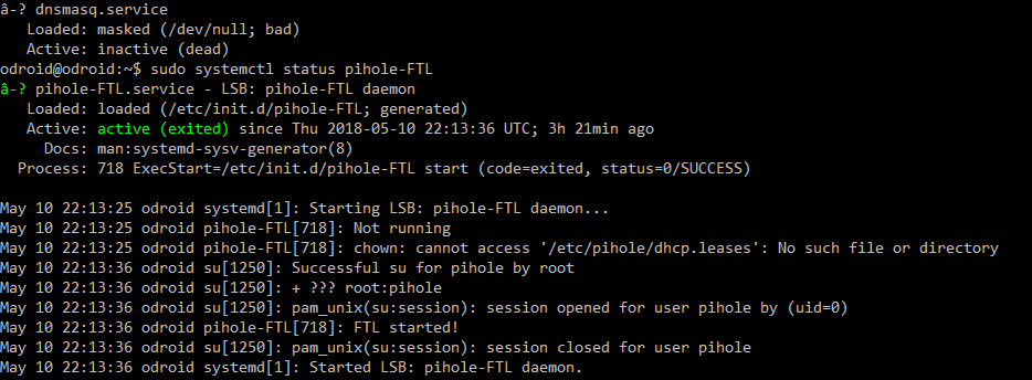

sudo systemctl status dnsmasq
sudo systemctl status pihole-FTL
If it does work, then run these 2 commands when failure occurs and save the output and paste it in this port so that we can see why it fails.
Things are working at the moment but I added the line to NetworkManager.conf and restarted everything as requested.
The next time the issue occurs (should be around 12:30AM) I'll get the output from the commands and post it here.
Thank you for your help so far.
I just realized that adding #dns=dnsmasq does absolutely nothing.

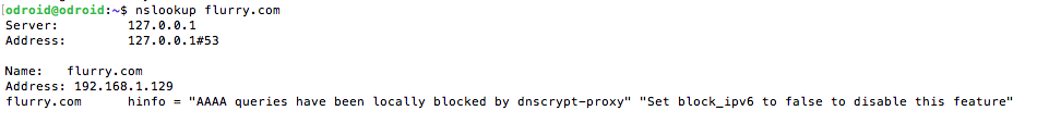

What does nslookup flurry.com return on the pi-hole device when DNS resolving fails on your devices?
Run the same command on a failing device.

Performing the nslookup helped me pinpoint the issue. It was definitely related to DNSCrypt Proxy.
I went into the config of DNSCrypt and disabled that feature. Fingers crossed that the issue has been resolved.
