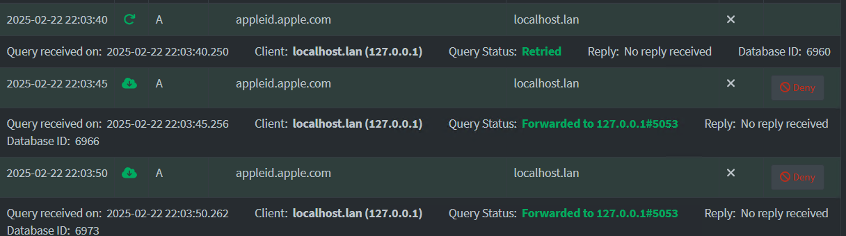

hm interesting in the GUI logs when I search for that same query this was the result.
also saw this which I band-aided in my last deployment. Learning from the original post that it was not a valid fix, but it worked ... never did find the actual fix for it
DNSMASQ_WARN Warning in dnsmasq core:
Maximum number of concurrent DNS queries reached (max: 150)

You were forwarding to port 5053. That is the port normally used with a Cloudflared installation. Our unbound guide uses port 5335 for unbound.

You previously had port 5053 configured, which as jtb says is usually associated with a different service, or might just have been a typo during install. Either way, Pi-hole had nothing there to talk to and hence it timed out, but going to Unbound directly still worked as expected.
The earlier command indeed is a command line way of configuring Pi-hole to use Unbound for its upstream server. You can also do this in Pi-hole's admin interface.
With this configured your query hits port 53, and the log in Pi-hole will show it being forwarded to port 5335.
