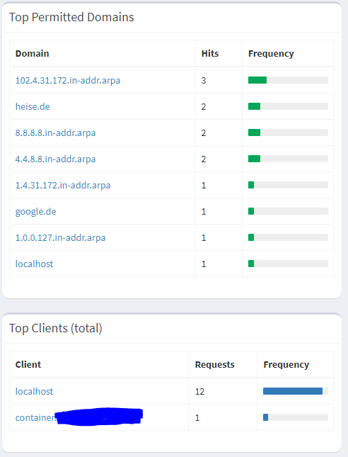

So, I set up an entirely new container only to ensure that the issue is not some permissions issue or something around that lines.
The outcome is, that the queries show up as localhost rather than pihole.example.com.

I can see that the pihole-FTL.conf file indeed contains the environment variables from the docker-compose.yml file:
#; Pi-hole FTL config file
#; Comments should start with #; to avoid issues with PHP and bash reading this file
LOCAL_IPV4=172.31.4.102
PIHOLE_PTR=HOSTNAMEFQDN
Unfortunately, the outcome is ultimately almost the same: localhost is now used instead of pi.hole to refer to the pihole instance.

I guess that's expected - requests originating from a loopback address (127.0.0.1) will always be shown as localhost.
