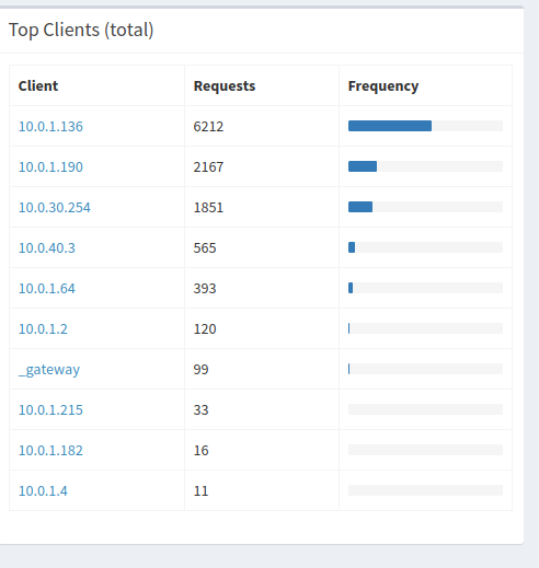

I can't get it to work - maybe I did it wrong.
I've used custom dns to give certain clients "friendly" names, but the won't be displayed on the dashboard or the query list.
I was using /etc/hosts before and it worked just fine but it was somehow cumbersome to edit the file instead of doing it via GUI.

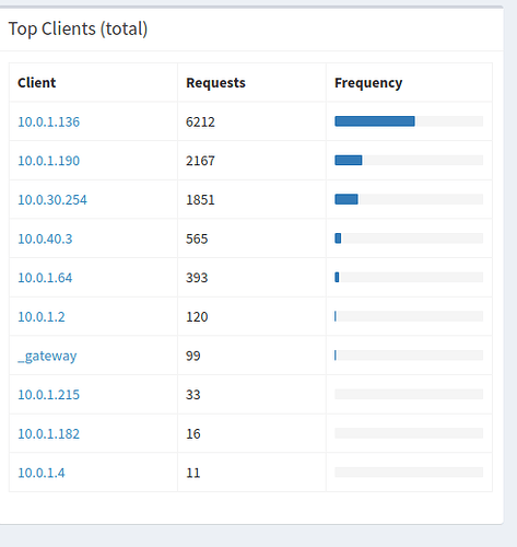

It's working but dashboard still looks like that

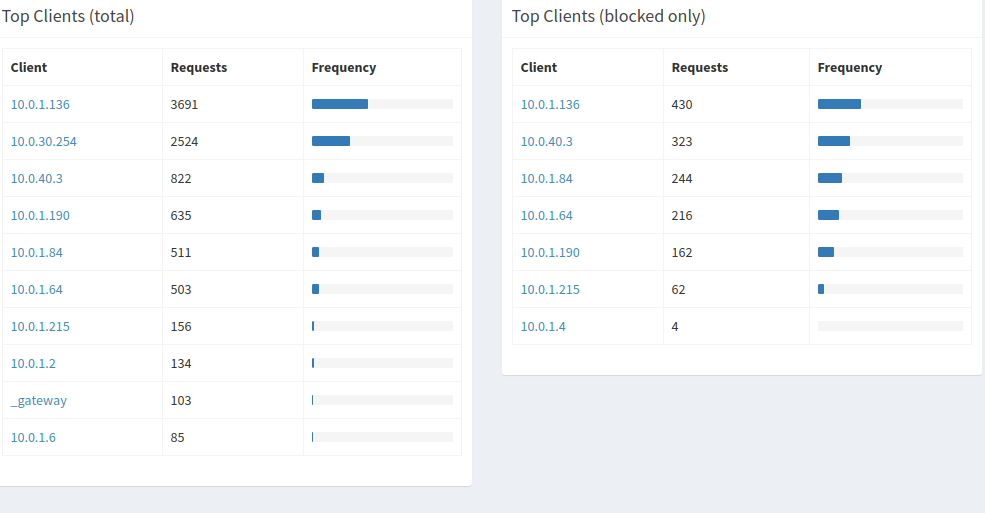

I don't see any PTRs from pihole itself (10.0.1.5) after
echo ">reresolve >quit" | nc 127.0.0.1 4711
If "RESOLVE_IPV4=yes" is necessary for custom DNS to work maybe it should be set by default when the first entry is set
Sorry, just saw that the first option is the default...

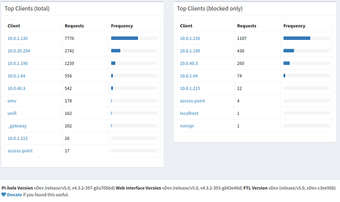

Updated pihole today and now they are partly "resolved" in the dashboard. Maybe that are the ones I issued the dig command for yesterday....

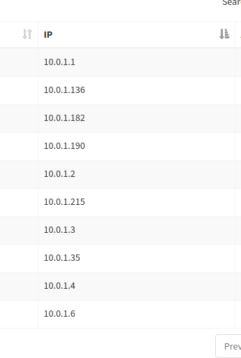

Side note:
The sorting in Custom DNS for IP is "kind of" broken, 10.0.1.1XX come before 10.0.1.2 but I would expect 10.0.1.1, 10.0.1.2, 10.0.1.1XX....
It does not need to be enabled explicitly but I see you have seen this already.
Yes, this is lexicographical instead of IP sorting. This page was an external contribution and it seems the contributor forgot to add this. I will try to remember changing this.
