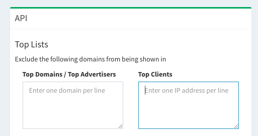

This is NOT covered by the exclusion options for the API "Top x" display. On an admin level this would be much more useful than excluding entries from the graphs.

@r0ckarong@derailius Would agree that simply extending the filtering from Top Lists also to Query Log or would we absolutely have to implement another filtering layer for that?
I see it from a different perspective. From your point of view programmatically it's "another filtering layer" for the user it's "another list I have to maintain". Since the "exclude from Top Lists is a totally different list than "Stuff I already know is safe (whitelist)" this is another "layer" of though you need to invest to easily maintain your filter.
To me it would make more logical sense to remove all whitelisted stuff from things like top lists and query log (when the option is chosen). This would make most "exclude from top" lists less long anyway and then they would only actually need to show domains that are not yet determined to be safe. If you know you have something constantly on the top list that is unsafe and needs to be there then (to me) would be the extra layer of "filter this from top as well".
In short: Extending the "exclude these" logic from Top lists to query log would be an improvement, sort of a workaround but not really the solution to the overall problem of disconnect between the filters and display lists.
