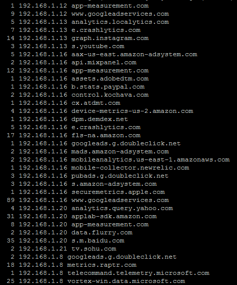

 grep 192.168.1.3 /var/log/pihole.log.1 | grep gravity.list | sed 's/^.*]:/]:/' | sed 's/^[^:]*://g' | sed 's/[^ ]* //' | sed 's/[^ ]* //' | sed -e 's/\/etc\/pihole\/gravity.list//g' | sed -e 's/is 192.168.1.3//g' | sed 's/\/[^/\]*  / /g' | sort | uniq -c
Of course the IP needs to be changed to your host.
Output:
this should be what @sycnewton needs :slight_smile:

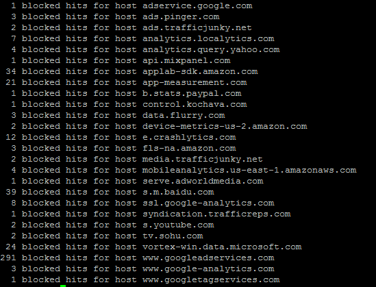

You can even use the bellow code to give the count for blocked hits only (no IPs)
grep 192.168.1.3 /var/log/pihole.log.1 | grep gravity.list | sed 's/^.*]:/]:/' | sed 's/^[^:]*://g' | sed 's/[^ ]* //' | sed 's/[^ ]* //' | sed -e 's/\/etc\/pihole\/gravity.list/ blocked hits for host/g' | sed -e 's/is 192.168.1.3//g' | sed 's/\/[^/\]*  / /g' | cut --complement -d " " -f 1 | sort | uniq -c
Output:
