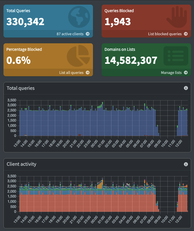

I run two pihole instances here, both behind Unbound, and both peering with my NextDNS account upstream. The primary instance runs in a LXD container on a VM, and the secondary runs in a Docker container on a Pi4. Ignore the brief maintenance window below, the primary failed over as expected, to my secondary.
This covers my LAN, WAN, VPN and off-premises needs perfectly. I'm using Nebula to keep them sync'd, and a very small keepalived script that flips the VIP from one to the other, preferring the primary with some weighting.
