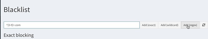

I have this expression ^\d+.com or [1]+.com but when I try to add them I get a message about the domain not being valid. Is it not possible, or is my expression not formed correctly?

That looks like the proper regex, but it needs to be entered as a regex, and not as a wildcard, since it is already in regex format:

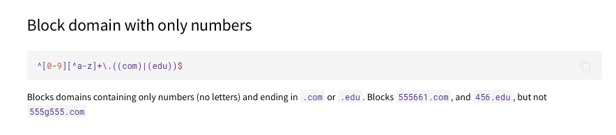

This section of the Pi-Hole documentation has a nice tutorial on regex:
Including the exact regex you are looking for:
I used the add (exact) button (thinking it was already regex). That explains it. I'll use the correct button, I suspect it will make all the difference!
Thanks for verifying the expression.
See the link above for a better expression.
This might be even better than the one posted above.
[1][^a-z]+.[a-z]{2,7}$ would account for all possible TLDs, but would not include ANY subdomains
would match 12.com but not abc.12.com
[0-9][^a-z]+.[a-z]{2,7}$ would match any number of subdomains abc.123.com or abc.abc.123.com
