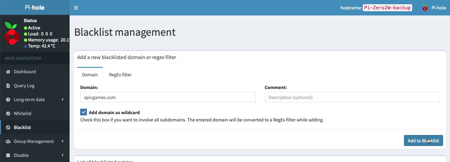

For example, ideally, I would like to block all variations of domains ending in epicgames.com. How can I accomplish this?

From the query log directly, you can only add a domain as an exact blacklist entry.
If you copy the domain to your clipboard and then go to the web admin GUI > Blacklist, paste the domain into the window and select "add as wildcard". This will create a regex for that domain that includes the domain and all subdomains.
