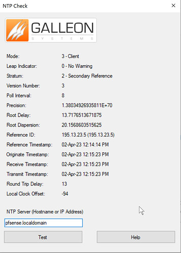

if you've setup everything, download (windows) a portable ntpcheck here, click on download (near bottom of page), run the download (portable - no installation) and test your config (enter fritz.box as NTP server), result looks like this:
than, repeat the test with one of the entries from the above list, this should return similar results.
query log should show:
OK (cache) and CNAME

I tested on android with a ntp time app the time server.
Like on raspbian 1.debian.pool.ntp.org is not working, but the direct call fritz.box is working.
The cname record has only worked reliably on ubuntu. I don't understand why and how to solve this.
The only difference seems to be, nslookup shows under ubuntu Server: 127.0.0.53 and raspbian the direct pihole ip address .
Does anyone have an idea to investigate the problem further?
