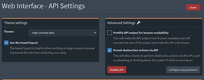

v6 has 2FA feature at Web interface / API ----> Expert mode / Advanced Settings
Thank you @smurf, I didn't know that. Certainly an easy change to make which would toughen security substantially.
