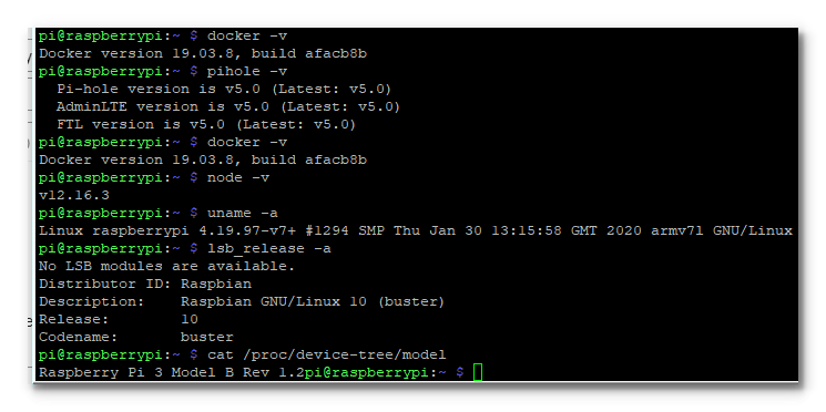

This screenshot can better summarize all what I am running on the raspberry Pi
Since the Raspberry Pi was underutilized by only running PIHole 4.4 , when I upgraded to V5 , i did also install the below
  1. Node-Red
  2. Docker (and some containers in Running state like Portainer, Grafana, InfluxDB , PingMonitor).
So based on the given information, can there be a definitive way to know what exactly is causing random freeze ups/ hang state of PiHole and no response on the ping command.
