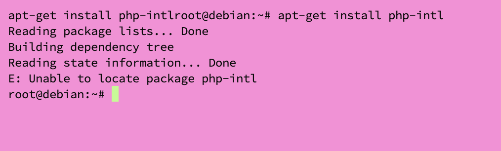

Recent update has cause connection to API issues. Also "Failed to Fork"
Update to v5 on Jessie tried the stuff from that, no luck
Ran out of replies. Started editing. Ran out of character limit. moved all to pastebin
