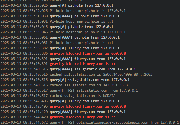

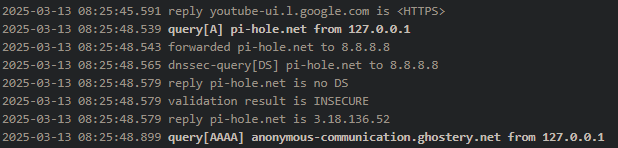

Pihole has been installed and configured on my system. I'm able to access the web interface on port 80, and according to Test-NetConnection (PowerShell) port 53 is also open. When running nslookup - server I can see the request arrive in pihole.log, and can also see that it is forwarding the request and receiving the (correct) result.
Yet somehow pihole seems to not be sending out the results to the client, thus I'm getting DNS request timed out messages back.

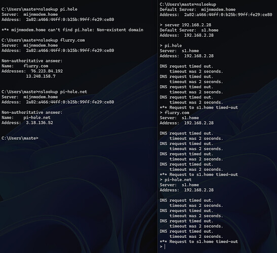

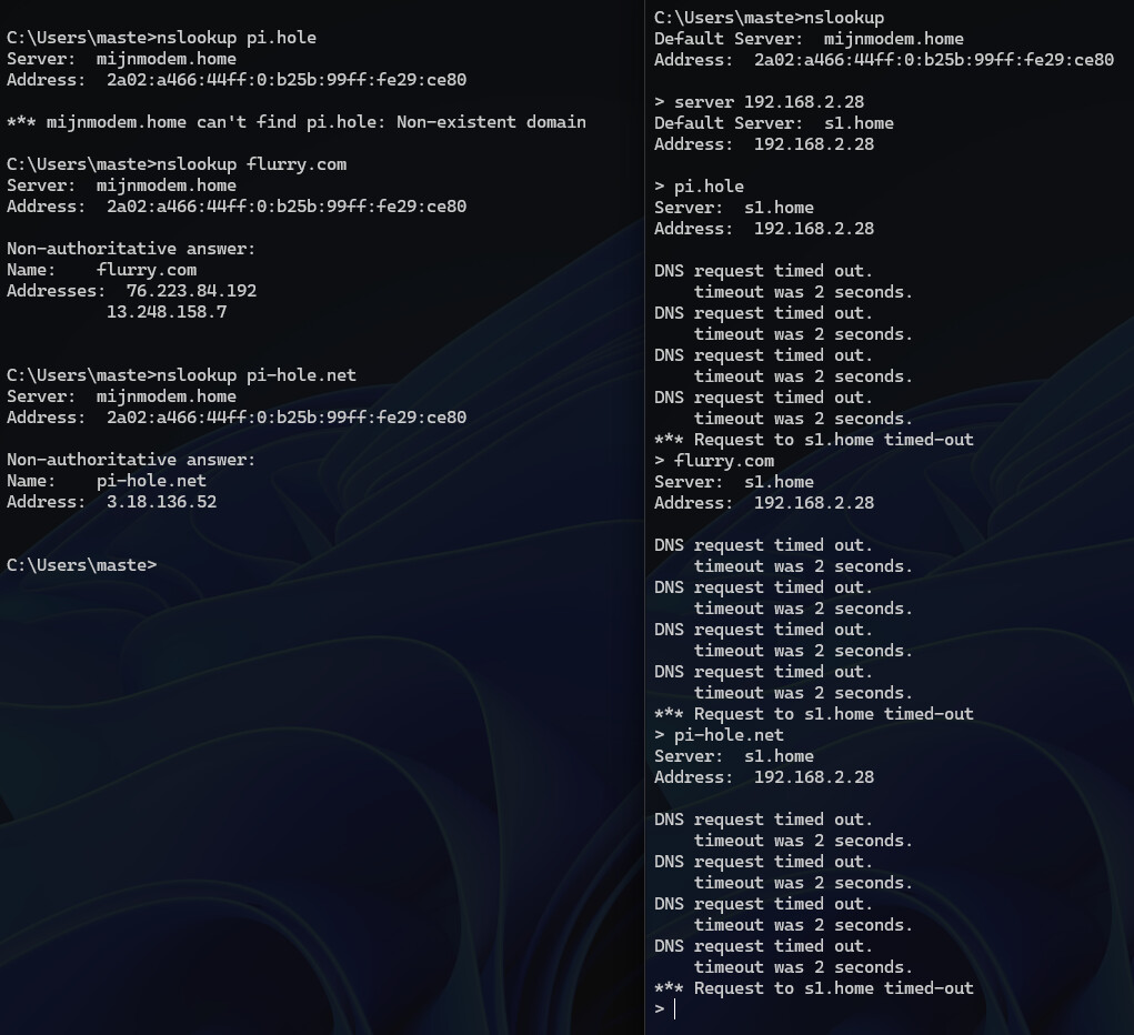

Run from a client in your network, please share the output of:
nslookup pi.hole
nslookup flurry.com
nslookup pi-hole.net
It does not matter which hostnames I try to look up, the DNS requests are not answered, even though they do show up in the logs.

They show that the Windows machine it runs on is not using Pi-hole for DNS, but an IPv6 address, which seems to belong to your router.
Since your router is advertising its own IPv6 address as DNS server, that would allow your clients to by-pass Pi-hole.
You'd have to find a way to configure your router to stop advertising its own IPv6 as DNS server, or to advertise your Pi-hole host machine's IPv6.
If your router doesn't support configuring IPv6 DNS, you could consider disabling IPv6 altogether, provided you'd not depend on IPv6 for reasons.
If your router doesn't support that either, your IPv6-capable clients will always be able to bypass Pi-hole via IPv6.

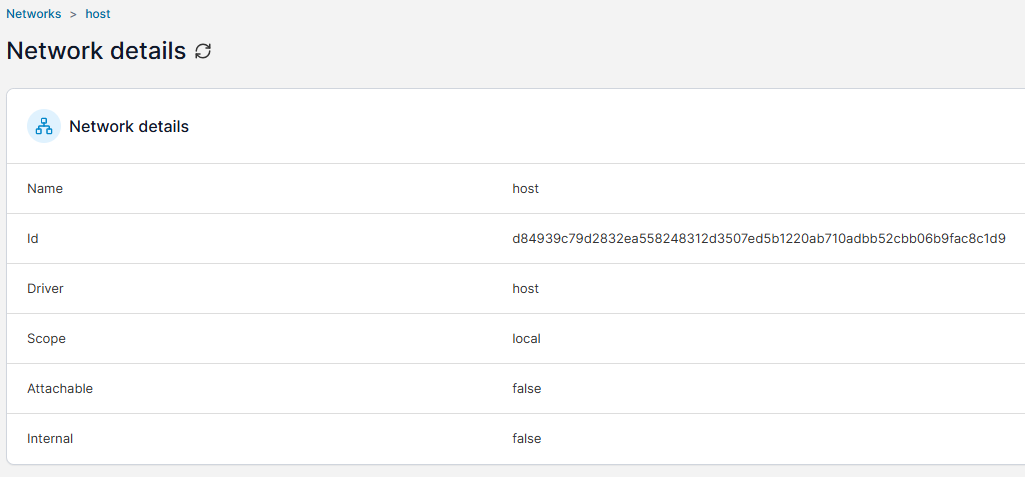

The only network it is connected to is "host":

The only thing not listed in the documentation is what network it should be connected to. I've chosen the "host" network hoping it would make accessing the Pi-hole the easiest. This does disregard the exposed ports, as all ports are directly mapped to the host system.
In host mode, the container would directly share the host's network, i.e. it would not have created additional IPs, but have had shared access to your 192.168.2.28.
Your docker inspect results show that your Docker host network is sparsely configured:

It's basically missing everything that would make it operational.
For a long time, Docker didn't support host network mode on Windows (as the docker daemon itself runs in a VM on Windows, i.e. it really can't share the host's network interfaces with its containers).
I think Docker started introducing host mode for its beta releases late 2024, but I wouldn't know whether that has GAed by now, nor how to enable it.
It would be easiest if you would run your Pi-hole container with Docker's default bridge network.
