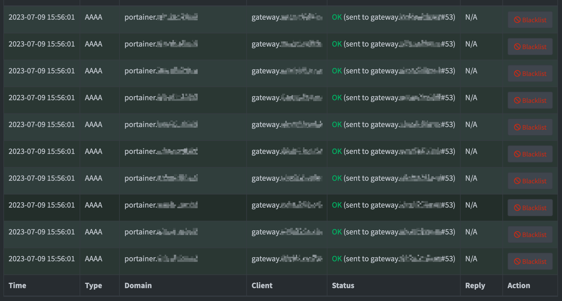

I am running Pi-hole in a Docker container for a few devices on my network. These devices are configured with a DHCP reservation which sets their DNS servers to my Pi-hole instance, rather than the router itself which is the resolver for other network clients.
Despite not being configured to use Pi-hole for DNS, my router is sending thousands of requests to Pi-hole which results in it being constantly rate-limited.
I've disabled rate limiting for the time being, but I'd like to know what the correct fix is. (edit: I've had to switch rate limiting back on since the web interface becomes unusable with the high amount of queries. I've set it to 100/10 for the time being)

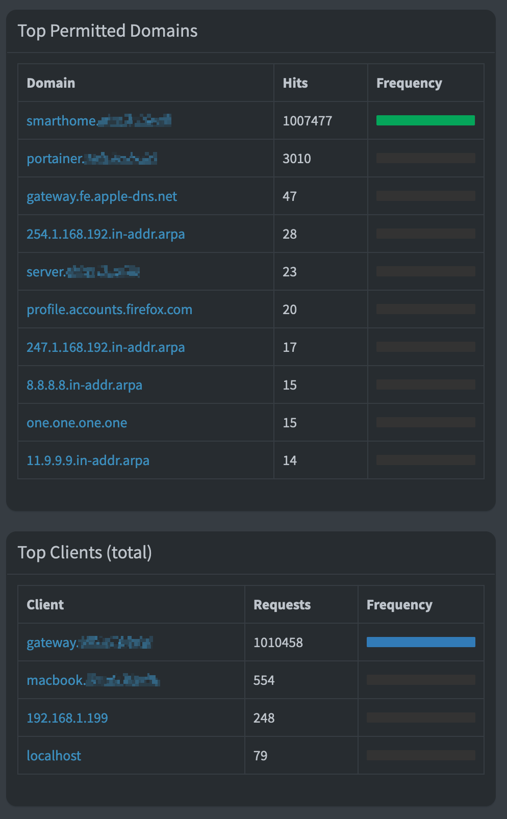

Below is a screenshot showing this behaviour, thousands of queries within the same second from my router (gateway.myinternal.domain) to one of my servers (portainer.myinternal.domain)
While writing this post I had over a million queries to another of my servers (smarthome.myinternal.domain) within 1 second.

What I do not undestand is you say 'Pi-Hole is set up to use my router as its upstream DNS server' yet your first image shows your router is a client of your pihole.
That's the confusing thing, there are currently only two devices on my network using Pi-hole for DNS resolution - my MacBook and my iPhone. Nothing else should be talking to Pi-Hole for DNS resolution. Any other machines wanting to resolve portainer.myinternal.domain will use my router for DNS, just as they did before I implemented Pi-Hole.
I can absolutely garauntee that my router is not configured in any way to use Pi-hole as its upstream DNS server. It's configured only to use Quad9 with cloudflare as a backup. This has been proved by the fact that after blocking UDP/53 from my router to the Pi-hole instance, this activity has ceased with no impact to my network.
