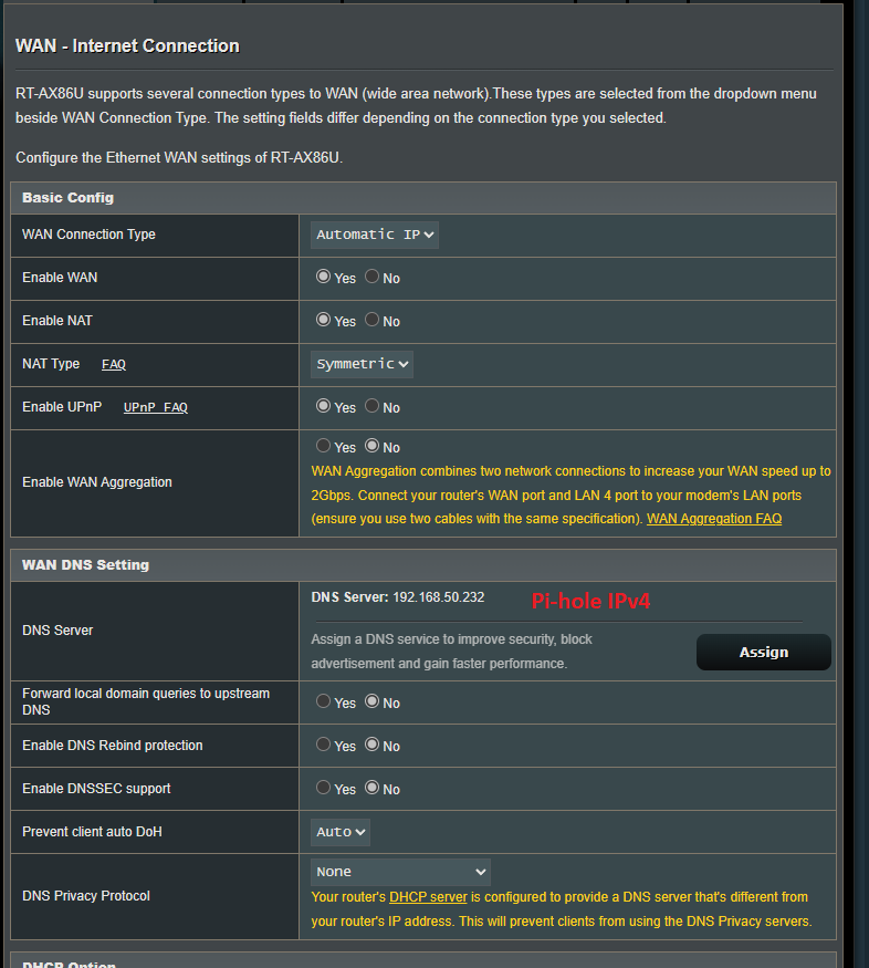

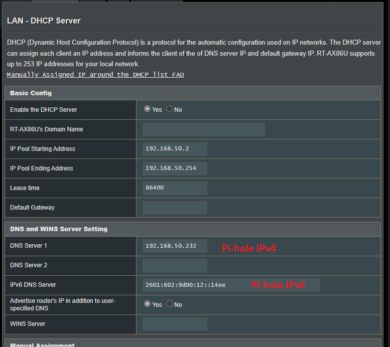

I do have the Pi-hole's IP address(es) set in the router's DNS fields for WAN and LAN:
Often, the pi-hole is giving me the error "Client 192.168.50.1 has been rate-limited (current config allows up to 1000 queries in 60 seconds)"
