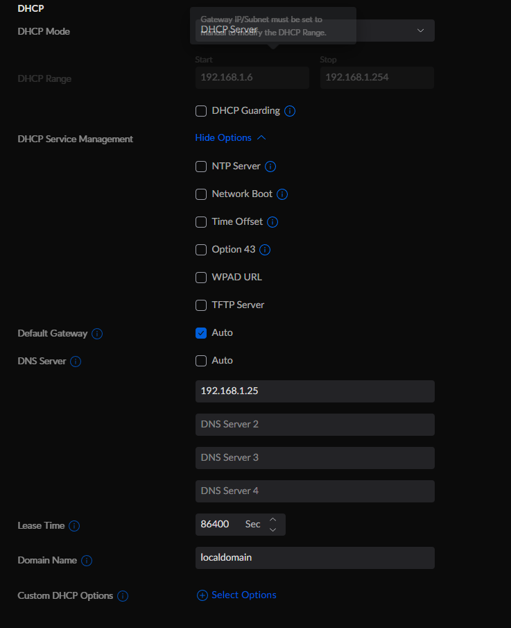

I found something like this:
Is it this?

Then in Settings/Networks, pick your LAN network name. Under "DHCP Service Management," click "Show Options." Here you can specify your Pihole's IP address under DHCP Server. Repeat this step for any additional VLANs you have configured.
This means your computers, phones, TVs, and other client devices use your Pihole for DNS. The UDM uses the specified public DNS (other Unifi or network hardware will use the UDM for DNS) and won't bombard your Pihole with "management" traffic generated by your network management hardware.

Thank you, your way is nice too but for me I leave DHCP as it was and just put Pi-hole DNS server into Settings -> Network -> Default -> DHCP Service Management -> DNS Server like my post above.
Pi-hole now see every each device and hopefully no more rate-limit notification.
