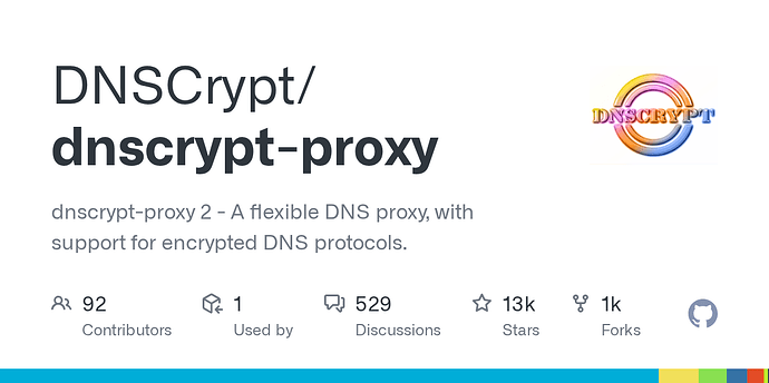

I have been doing DoH for over 4 years here at home using the DNSCrypt-Proxy service which you can configure if you want DoH, DNScrypt, etc.
