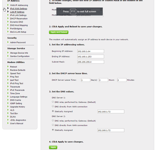

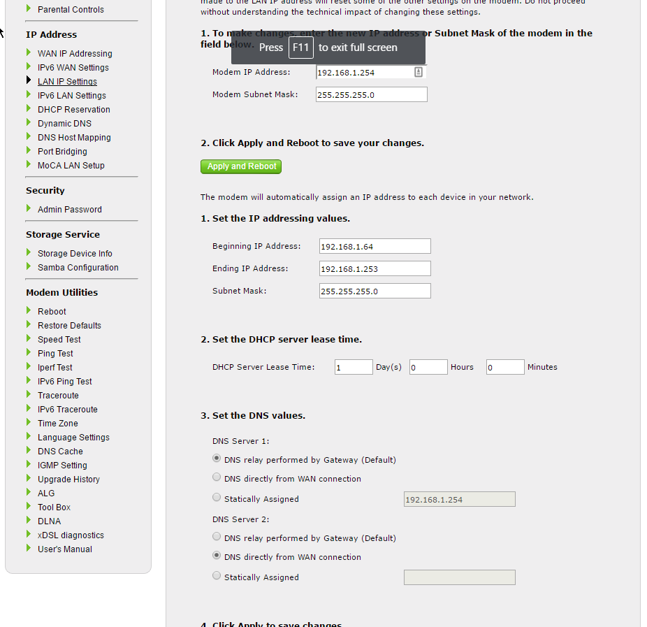

After I update the settings on my router like this
Restart all my devices - including router, pi, and desktop.
My internet does not work on any device and says dns failed to resolve.

Change the DNS settings in the LAN section, not the WAN section.
@Mcat12 that fixed it. Thank you so much.

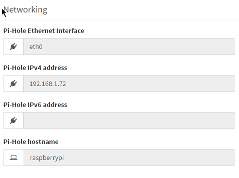

What was the problem? The empty IPv6 field? If so, the fields are only populated during running the installer. That will have updated it for you.
