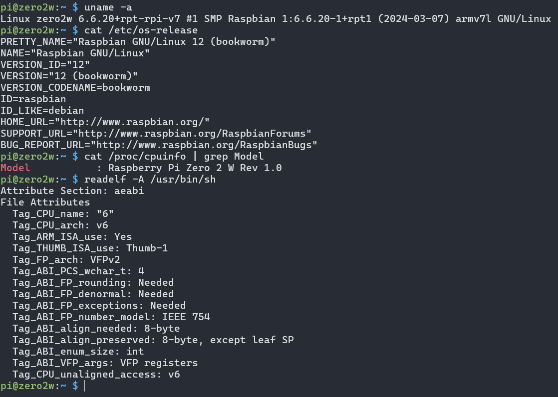

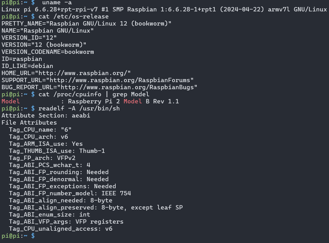

Hi, I'm just posting this as an observation. Both my pi2 and zero2w get detected as Armv6 when running the 32bit Raspberry Pi OS, even though they support ArmV7. I'm not sure what happens on a pi3/4/5.
It seems like ArmV7 never gets detected. I don't know if that matters? It might save you building/maintaining the V7 binary.

Your output is for /usr/bin/sh:
usr-bin-sh

Hi, apologies if my post isn't clear. I'm not really flagging it as PiHole bug, just raising it as an FYI.
I believe the v6 install script detects the architecture on 32bit builds by running readelf -A /usr/bin/sh
That's why I posted the output.
Although there's a check in the script for detecting Armv7m it seems like currently that won't get triggered - at least on Raspberry Pi OS.

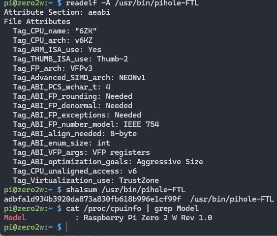

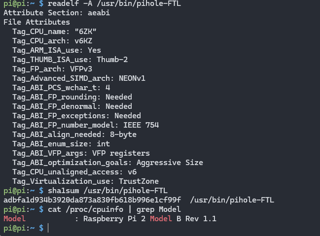

Are you saying that you actually observe Pi-hole's v6 installation scripts to pull pihole-FTL binaries for ARMv6 on systems with ARMv7/8 CPUs?
Could you share readelf output for your pihole-FTL?
Thanks for replying, no worries about the delay. Yes, that's what's I'm getting at, but specifically on Raspberry Pi OS 32 bit. Sorry, that was very poorly communicated.
Is this what you need?
