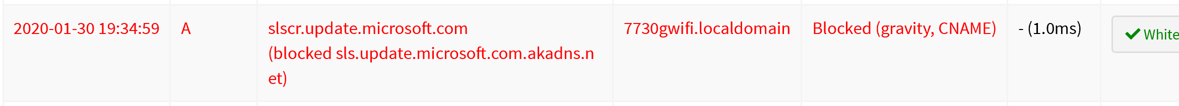

The result of the new query log feature:
Whitelisted the domain (the CNAME), problem fixed, windows update works.
The CNAME was on a blacklist, provided by Spybot Anti-Beacon
It took me less than 2 minutes to identify the culprit. This feature is a great addition to pihole.
You shouldn't need to whitelist the CNAME. That will open up that for any domain that points to the CNAME. You just need to whitelist the target domain and leave the CNAME alone.

The dilemma is, when I run pihole -q, the domain apparently isn't on any blocklist
pihole -q slscr.update.microsoft.com
  [i] No results found for slscr.update.microsoft.com within the block lists
So I would be whitelisting something NOT on any blocklist. Is that wise?
Yes, if you want to access them.
You want to see blog.site but that CNAMEs to bad.tracker. If you whitelist bad.tracker then any domain that points will now be allowed. Just whitelist blog.site and only that domain will be allowed.
Thanks for the advice. I will change the whitelist entry.
