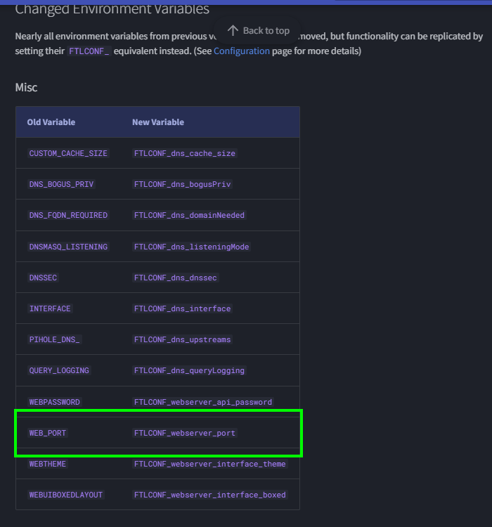

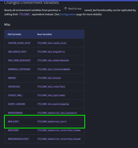

Unfortunately, on docker i use the host network mode, so the port setting on the docker file its not working on me.. for v5, we had the WEB_PORT: 7000 variable that was the config that worked for me, unfortunately, seems like on v6 this is not an option anymore...
Changing the pihole.toml file did the trick form me. thanks!
It's in the manual that was linked from the announcement post :wink:
