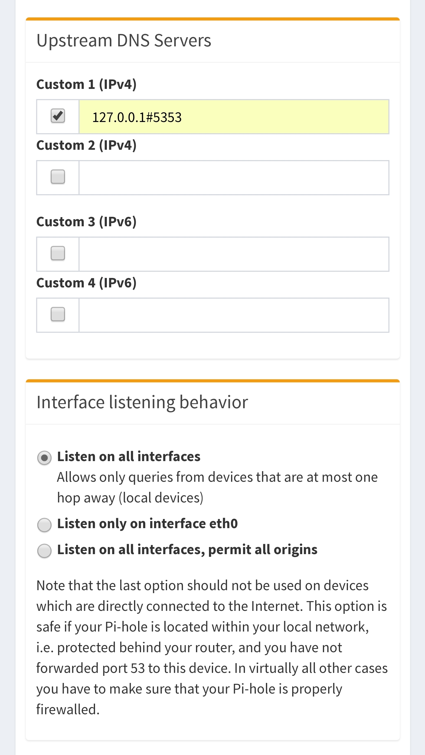

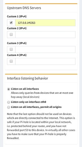

Does this mean it should now work if inset pihole upstream as 127.0.0.1#5353
And start unbound with sudo service unbound start
I've left chroot: "" in the unbound config, see how it runs.
